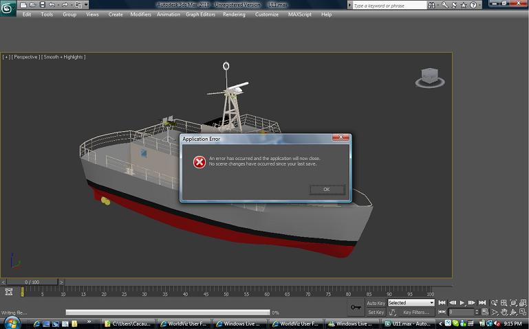

Hi Paul,
I'm trying to send the error snapshot here....
Thank you for your help,
Claudio

Have you guys seen this kind of error before. Seems like a version issue between Max and the OSG exporter.
Claudio,
Do you have any other OSG applications on your computer? Perhaps some other OSG dll file is on your PATH variable that the exporter is trying to use?

I reinstalled Max2010 and OSGExport but nothing changed, the error still occuring when a Export to OSG. I've posted a snapshot of error message at the "plug-in development" Forum. Is there any other thing that I could try?
Thanks for your time, regards,
Claudio

My name is Claudio and I'm have a problem to export .OSG file in 3DS MAx 2010. It seems to be installed (OSG Export) correctly in Max 2010, but the problem is that in the middle of the exporting process an error occurs and close the Max application and don't export the model. I tried to export an model and also a simple Box, even the box returned the error, so I guess the problem is not in my model...
Can you help me?
Regards,
Claudio

Paul,
I'm not sure if they're related to OSG, but the only possible applications I have installed are:
- Delta 3D;
- Dark GDK; and
- Blender.
I made the download of OSGEdit and tried to run the osgedit.exe, but I gotta an error also and give-up about that...
Is it possible to check the correct path by myself?
Once again thank you for your attention,
Claudio

Delta3D is an OSG based tool. I remember that their installer adds the Delta3D bin/dll directory to the PATH variable. This is probably causing the problem.
You can remove the Delta3D entry from the PATH environment variable by right clicking on My Computer->Properties->Advanced Tab->Environment Variables Button.
Under System Variables, select the Path variable, click edit, then remove the Delta3D entry. If you have problems with this, search google for guides on changing the Path Environment Variables with pictures.
Changing the Path will break Delta3D I assume though.

Paul,
You're a genius!!! I removed the Delta's Path and it worked smoothly!!!!!! Thank you very much for your help!
Best Regards,
Claudio
