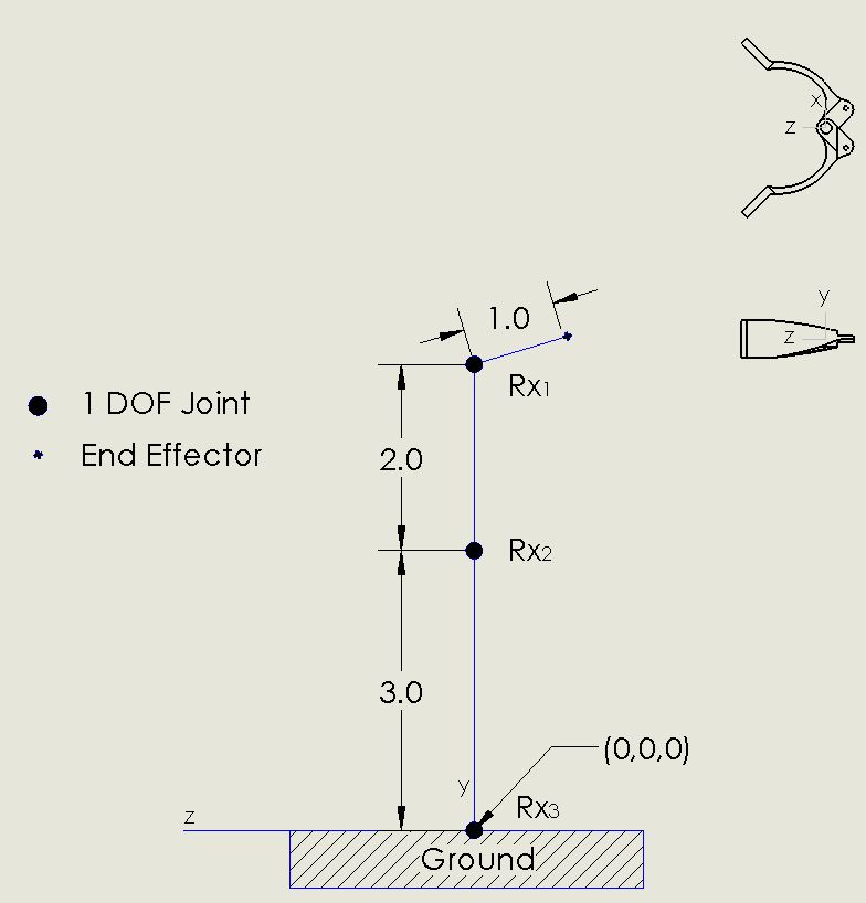

I'm trying to find the best way to simulate my grasper (like a tweezer- referred to as "babcock" in my code), which is driven by a custom joystick (I'm including an example picture (attachment # 1) of my joystick (left) and grasper (like a tweezer, on the right) for clarity).
I'm trying to rotate my grasper around three different axes (Rx1, Rx2, Rx3). Therefore, I'm currently thinking the best way to accomplish this is by:
  1. read in data[],
  2. assign new center to Rx1, complete euler rotation # 1,
  3. assign new center to Rx2, complete euler rotation # 2,
  4. assign new center to Rx3, complete euler rotation # 3.

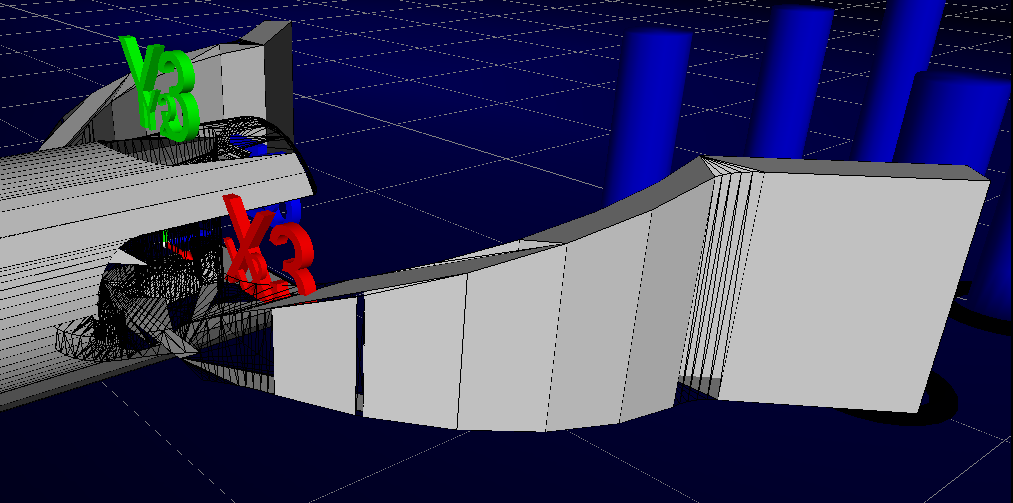

However, when I assign a new center from the original grasper origin, 1 unit in the z-direction away (to obtain Rx1), the center remains at the original origin (as seen in attachment # 3).
	# move babcock up and forward a bit (1.25, 2) from World Coordinate System
	babcock.setPosition([0,1.25, 2+ data[2]],viz.ABS_GLOBAL)	 # data[2] = TRANSLATION potentiometer
	babcock_axes = vizshape.addAxes(parent = babcock, pos=[0,0,0],scale=[.05,.05,.05])
	X2 = viz.addText3D('X2',pos=[0.1,0,0],color=viz.RED,scale=[0.05,0.05,0.05],parent=babcock)
	Y2 = viz.addText3D('Y2',pos=[0,0.1,0],color=viz.GREEN,scale=[0.05,0.05,0.05],align=viz.ALIGN_CENTER_BASE,parent=babcock)
	Z2 = viz.addText3D('Z2',pos=[0,0,0.1],color=viz.BLUE,scale=[0.05,0.05,0.05],align=viz.ALIGN_CENTER_BASE,parent=babcock)
	# center of rotation is 3.5 from original (LCS)
	babcock.center(0, 0, 1) #change center of rotation to Z0 + 1 (DOESN'T WORK?)
	babcock_axes2 = vizshape.addAxes(parent = babcock, pos=[0,0,0], scale = [.05,.05,.05]) #CHANGE local axis to babcock (0,0,1) for Rx1 Rotation
	X3 = viz.addText3D('X3',pos=[0.1,0,0],color=viz.RED,scale=[0.1,0.1,0.1],parent=babcock)
	Y3 = viz.addText3D('Y3',pos=[0,0.1,0],color=viz.GREEN,scale=[0.1,0.1,0.1],align=viz.ALIGN_CENTER_BASE,parent=babcock)
	Z3 = viz.addText3D('Z3',pos=[0,0,0.1],color=viz.BLUE,scale=[0.1,0.1,0.1],align=viz.ALIGN_CENTER_BASE,parent=babcock)
	# why is the new babcock.center over the previous still? attached pic # 3
Furthermore, when I use the spin feature, the new center seems to work correctly.
	babcock.addAction( vizact.spin(1,0,0,90)) #for testing purposes only
Any suggestions if there is a better method using transformation matrices to accomplish this task? I would use linking, but my virtual grasper is only comprised of the tweezer (babcock) (it does not have the other links as does the joystick in the picture).
