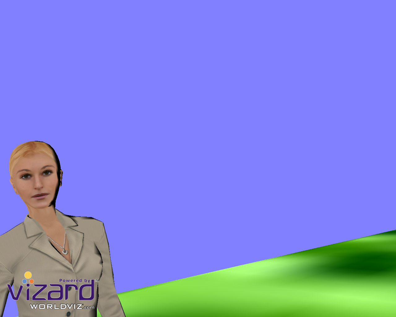

RE: Hi Veleno,
Hi Veleno,
thank you for reply...
Texture looks fine now, but still something wrong with model. Please take a look to attached image. There is a black "shadows" around model.
P.S. Sorry for my English...

Old 01-19-2011, 06:27 AM
Darkmax Darkmax is offline
Join Date: Feb 2010
Posts: 108
check this thread:
http://forum.worldviz.com/showthread.php?t=1235
Old 01-20-2011, 10:48 PM
turgutm turgutm is offline
Join Date: Sep 2010
Posts: 15
RE : Rocketbox -> cal3D exported character
That's exactly what I was looking for ...
Great thanks.
