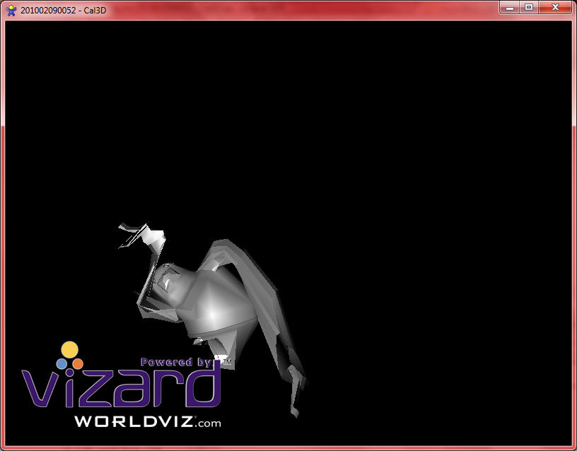

2. The animation and the mesh are not good coordinated, the mesh is extremely stretched, see pictures below...
3. If the character has a large amount of polygons, 3Ds MAX will crash when exporting the Cal3D mesh file...

2. Under normal conditions, the problems you are seeing only happen when a mesh is exported onto a different skeleton than the one it was skinned to in max. If you'd like, I can take a look at the model.
