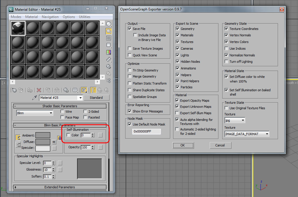

Make sure your self illumination is not set to 100%.
I have attached a screen shot from my 3DS Max 2011 material editor and IVE File export.
