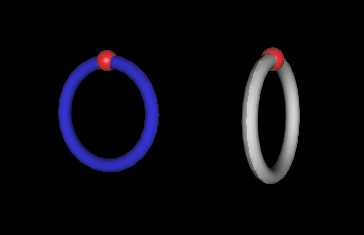

For illustrating I attached some screen shots:
Left picture:
Start position. object1 = blue torus, object2 = white torus)

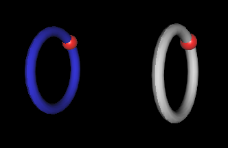

Middle picture:
Your end position. Your code seems to copy the complete orientation of object2 to object1

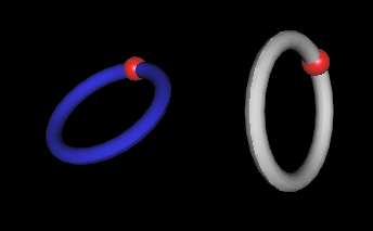

Right picture:
Desired end position. I want to rotate object1 according to the orientation of object2. Kinda object1.setEuler([0,0,45],viz.REL_LOCAL_of_object2)
ID:	316   Click image for larger version
ID:	317   Click image for larger version
Old 05-06-2009, 11:37 AM
Ok, it sounds like you want a hierarchical relationship between object1 and object2. In this case you would simply add object1 as a child to object2. When object2 is rotated, object1 will automatically rotate in object2's reference frame. If for some reason you don't want a to use a hierarchical relationship, then here is some code to manually compute the matrix:
euler = viz.Matrix.euler(0,0,roll)
m1 = object1.getMatrix()
m2 = object2.getMatrix()
diff = m1 * m2.inverse()
m2new = euler * m2
object2.setQuat(m2new.getQuat())
object1.setMatrix(diff * m2new)

Old 05-11-2009, 09:54 AM
Penguin Penguin is offline
Join Date: Mar 2009
Posts: 14
Thank you, the code works best for me! I only did some minor changes: translating to origin before rotating:
m1.setTrans(0,0,0)
m2.setTrans(0,0,0)
m2new = euler * m2
m1new = diff * m2new
m1new.setTrans(object1.getPosition(viz.ABS_GLOBAL))
object1.setMatrix(m1new)
