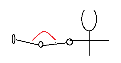

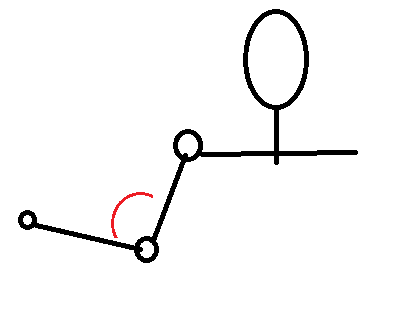

I'm a beginner to Vizard. I'm trying to write code that will recognize when the user has their right arm in a right angle. I'm using vizmat.AngleBetweenVectors() to try and get the angle between the right shoulder and the right hand. To my mind, if you hold your arm at a right angle, it will read ~90 degrees.
I'm encountering two problems:
1) As I move my arm back and forth, holding it at a right angle, the degrees change.
2) It's not reading 90 degrees.
Here is my code:
def RightArmAngle():
    RShoulder = vrpn.addTracker('Tracker0@localhost',RIGHTSHOULDER)
    RSpos = RShoulder.getPosition()
    RHand  =vrpn.addTracker('Tracker0@localhost',RIGHTHAND)
    RHpos = RHand.getPosition()
    RHvec = viz.Vector(RHand.getPosition(),normalize = True)
    RSvec = viz.Vector(RShoulder.getPosition(),normalize = True)
    RAVector=vizmat.AngleBetweenVector(RSvec,RHvec)#RAVector and RAAngle return the same value
    RAAngle = vizmat.AngleBetweenVector(RSpos,RHvec)
    print("r elbow:",RHvec)
    print("r shoulder:",RSvec)
    print("position Angle:", RAAngle, "vs RAVector",RAVector)
    print("new")
vizact.ontimer(1,RightArmAngle)
Here are some diagrams and my outputs:
Raised Arm, Turned to Side. Vector Returned: ~31
Right-Angled Arm, Held in Front, Vector Returned: ~23
Name:	rightish angle.png
Right-Angled Arm, Held to Side, Vector Returned: ~16
I'm confused as to how thought this would be a simple way. Should I try to make a triangle instead? Or should I just be returning one Euler value and finding the angle from that?

You would need to track three points (hand, elbow, and shoulder) in order to get two vectors and then calculate the angle between those.
