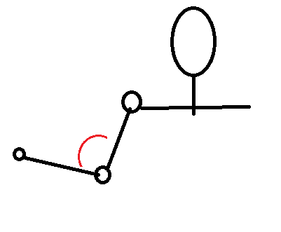

Here are some diagrams and my outputs:
Attachment 694
Raised Arm, Turned to Side. Vector Returned: ~31
Attachment 692
Right-Angled Arm, Held in Front, Vector Returned: ~23
Attachment 693
Right-Angled Arm, Held to Side, Vector Returned: ~16
I'm confused as to how thought this would be a simple way. Should I try to make a triangle instead? Or should I just be returning one Euler value and finding the angle from that?
Jeff 04-09-2015 07:01 PM
You would need to track three points (hand, elbow, and shoulder) in order to get two vectors and then calculate the angle between those.
