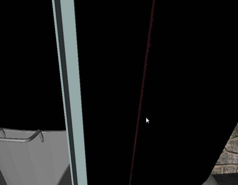

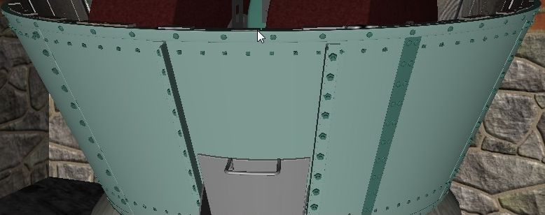

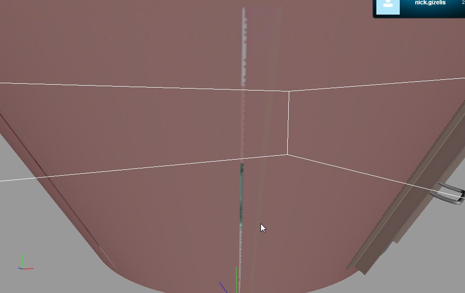

Hi Vizards!
I am trying to use a normal map in Vizard which should be straightforward, but guess what! I have read all the related posts in the forum but nothing helps. I have tried two ways:
- apply the map as a normal bump in 3DSMax (image '_3ds render') and export in osg format to Vizard (image '_inspector')
- apply the map in Vizard using the bumpmap command (file '_bumpmap')
You can see from the results that none of the two works. In the exported osg the map is barely visible in Vizard, and the one using the Vizard command is black. I assume that the OSG format does not save bump materials, according to this article http://kb.worldviz.com/articles/1393. Is it true?
But why doesn't the command work and I get the black color?
One more think I noticed is the hollow line where the seams are supposed to be. These do not exist in the 3DSMax render, but appear in Vizard in either of the two methods. Why is that?
I also include the original full polygon model as seen in Vizard, and the normal map itself (looks fine to me).
Thank you for your help,
--tokola
Name:	normal_3ds render.jpg
ID:	576   Click image for larger version
ID:	577   Click image for larger version
ID:	578   Click image for larger version
ID:	579   Click image for larger version

Currently exporting a model with normal map is not supported. If you use the bumpmap command you will also need to set the diffuse texture:
#Apply diffuse texture to unit 1
model.texture(diff,'',1)
#Apply normal map texture to unit 0
model.bumpmap(norm,'',0)
Have you tried that?

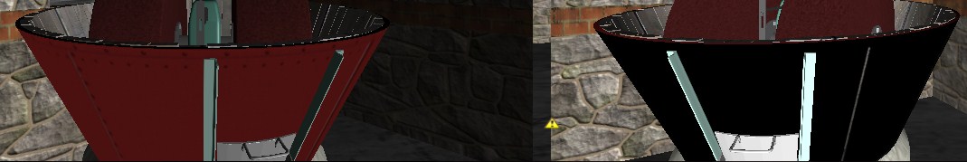

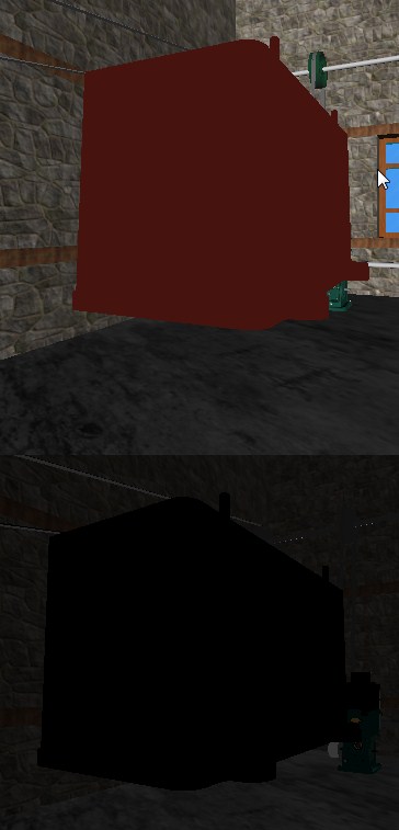

Red face Normal maps problem - update
Hi Jeff,
thanks for responding. It seems things were really 'quite' in here lately, and have some other questions pending.
As for the normal maps, I can't say my attempt was too successful. I include examples with two different models (attached images). They both appear black with headlight enabled (is this correct?), but have a red hue when inserting a light in Vizard. The second case also gives me the error:
** WARNING: Could not generate tangent/binormal data for geometry '03 - Default'
The code I am using is identical in both cases:
def applyNormalToTank():
        tank=viz.add('models/pump_tank.ive')
	normal=viz.add('models/images/testNormal.jpg')
	diffuse=viz.add('models/images/Roiled Concrete.tga')
	tank.texture(diffuse,'',1)
	tank.bumpmap(normal,'',0)
So the questions are basically why I don't get the right texture but instead get this red color and why the error in the second case? (I assume the headlight problem is the natural behavior?)
Thanks a lot!
--tokola
ID:	582   Click image for larger version

You should avoid using the node.bumpmap command. It is not documented and only exists for backwards compatibility. You will need to use GLSL shaders to make use of normal maps in Vizard.
The following thread contains a Vizard script for performing a parallax/bump effect:
http://forum.worldviz.com/showthread.php?t=1145
