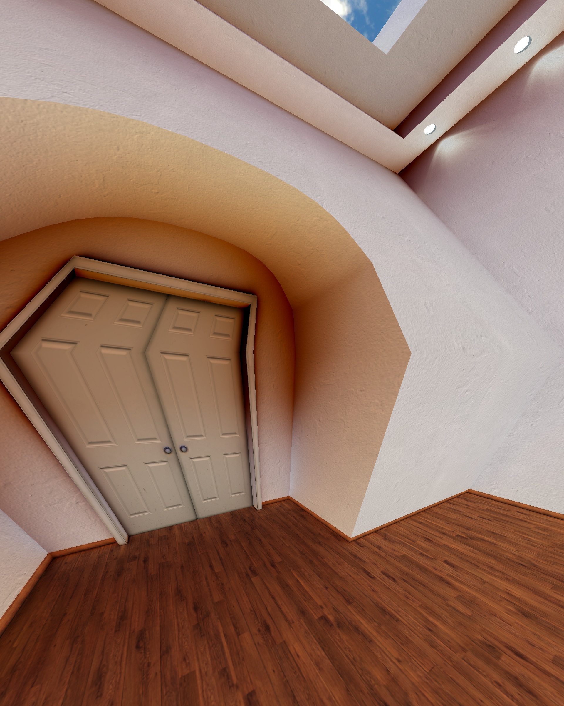

setup two wall system with one single PC and one quadro graphics card
I am trying to set up a two wall system (front and bottom) which is powered by a single PC and single graphics card (Quadro FX 6000). I am struggling with the setup.
I am creating two windows. Each image is projected to each window. However the image of front window and image of bottom window is not continuous. Could one of you give me a hint? Here is my code. Thanks.

I used your model. I still see some discontinuity at the edge. With stereo is turned on, it looks like the floor image on the bottom screen is higher than the floor image on the front screen. Could this because my dimensions are not correct?

I have no problem with stereo. The problem is that the floor image is not continuous with the front image at the edge. If I manually offset the floor image down for about -0.6, the image seems align with the front image quite well, i.e. the codes look like (the rest is the same)
C4 = -W/2,-H/2-0.5,-D/2
C5 = -W/2,-H/2-0.5,D/2
C6 = W/2,-H/2-0.5,D/2
C7 = W/2,-H/2-0.5,-D/2
The value "0.5" is obtained by trial and error. Is there any reason for this phenomenon?

Old 05-26-2012, 03:46 PM
vrmdl vrmdl is offline
Join Date: Mar 2012
Posts: 14
Swap eye image for one window
Originally Posted by farshizzo View Post
Do you see the discontinuity between the two windows when viewing on a desktop? If so, can you post a screenshot.
Or do you only see the discontinuity when viewing on the actual projected surface of your CAVE? If so, then your projectors might not be properly aligned.
I am currently working on a two wall system which is driven by the same computer and one graphics card. I generated one front image and one floor image.
The screenshot is attached. Is this due to the projector alignment problem?
Thanks.
Old 05-29-2012, 10:27 AM
Are you sure the dimensions of the wall you are specifying in your script match the physical dimensions of the projected image? Also, the physical coordinates of the wall must be in the same coordinate frame as the tracker you are using to track the users head position.
Old 05-29-2012, 10:59 AM
Join Date: Mar 2012
Posts: 14
I am sure the dimensions of the wall is correct. I am not currently using any physical tracking system. The cave center is assumed to the origin of the coordinate system.
I suspect if the left and right eye image of the bottom screen are swapped while it is not for the front screen. How do I swap images for a particular screen. Is this possible in vizard?
The complete code is listed below.
