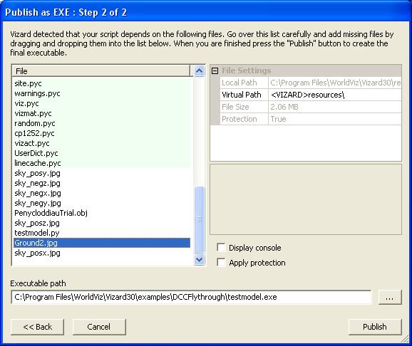

Hi - the model file (PenycloddiaTrial.obj) is in the Vizard Resources folder, along with the texture - see attached files showing virtual path for both. The Vizard script is in a subdirectory of the Vizard examples folder. On previous occasions this always seemed to work fine and it still does, with the exception of the executable.
The attached are for a much simplified version of the model with only one simple part of the whole model and one texture (Ground2) for which I am seeing the same problem.
If in this case I attach the texture with viz.addTexture within the script (as Dwaik suggested) then it does work ok but the model has many subcomponents and it would be a pain to add import them all and add the textures individually.
Because of this I thought it may be something in the way I am exporting the obj file from 3DsMax - though I haven't changed any settings and I cannot see why Vizard would see it in Step 1 of the Save to Executable but then lose the texture on step 2.
I am still sure that it is something really simple and obvious but at the moment I am just going slowly mad!!
Thanks for any help
ID:	394   Click image for larger version
