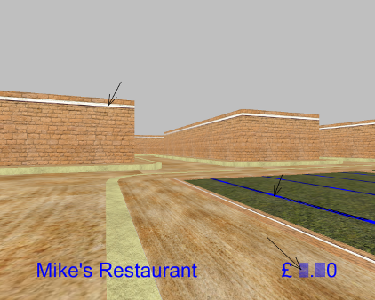

I've another graphics problem (different computer this time - indeed the laptop I was having trouble with in the other thread doesn't have this problem).
On a couple of computers I've run my vizard environment on, I find the textures become horribly scrambled: there's gaps at the edges of tiles, and textures from one object are being drawn on another - such that one fades into the other texture as you approach (see attached images).
It often appears that the font becomes scrambled too.
I'm wondering if it's because I'm only using OpenGL 1.4? Is there a minimum OpenGL version that Vizard will be happy with?
The objects are exports from 3DSM (in .WRL format, using default export settings). The textures are in png and jpg formats - their dimensions aren't necessarily powers of 2.
ID:	359   Click image for larger version

Okay, I tried it out on the other computer.
The problem in textures occurs only when a new environment is loaded and the old objects are deleted from the scene (I'll post some code later!).
