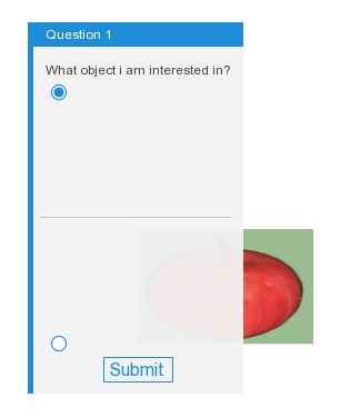

Dear all,
As shown in my attached jpeg file I want texture map to come in front of infoBox (i.e. in the foreground) but it is coming in the background. How do i can solve it? I am attaching my source code for the same. Please help in it.

To force the texture quad over the info panel, set the quad's draw order to a higher number. Here's an example:
Press 1 to set quad above
Press 2 to set quad below
import vizinfo
quad = viz.addTexQuad(parent=viz.ORTHO, scale=[100]*3)
quad.texture(viz.addTexture('lake3.jpg'))
quad.alignment(viz.ALIGN_CENTER_CENTER)
viz.link(viz.CenterCenter, quad)
info = vizinfo.InfoPanel(title='This is a vizinfo panel', align=viz.ALIGN_CENTER_CENTER,icon=False)
def setQuadAbove():
	quad.drawOrder(10)
def setQuadBelow():
	quad.drawOrder(-10)
vizact.onkeydown('1',setQuadAbove)
vizact.onkeydown('2',setQuadBelow)

Thanks a lot Jeff! It is working
