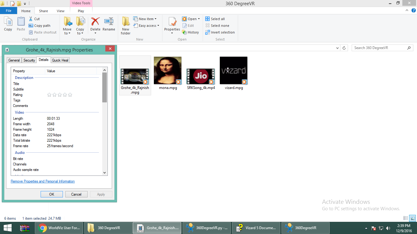

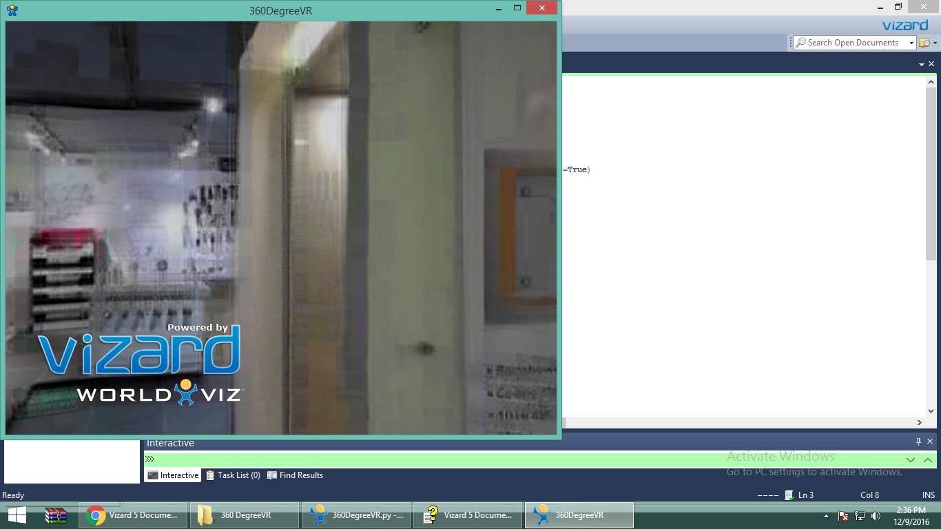

I got the 360 Degree Spherical Video played on to the sphere and i can view the video nicely .
But the video looks too much blurred,as the same video played in Windows media player view looks nice but the video played into Vizard looks blurred.
My video have 2K as resolution.
PFA of the screen shot for view and suggest me a solution so that i may the actual HD video 360 VR view.
PFA of the Vizard Render View when 360 video is played,the details of the video and the Video Played in the Windows media player .
