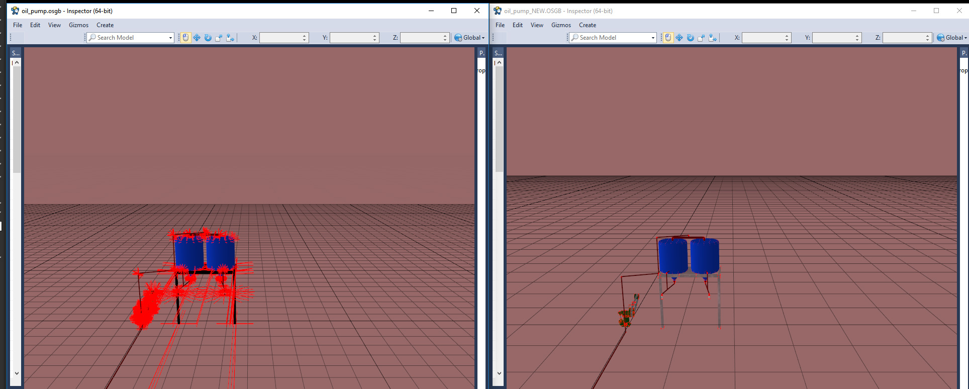

I am exporting a previously created model (in 3DS Max version 12) with the latest OSG exporter and I can't make cylindrical objects appear as smooth as they actually are in 3DS (the edges of vertices are visible). The older exporter seems to have been making a better job, unless I am missing something. I've tried almost every option in the exporter dialog box, but could not reproduce the desired result.
Please, have a look at the attached image to get an idea. The image on the right has been exporter with the old version, while the one on the left with the latest version from 3DS Max 15. Any idea why this is happening? I can attach the model, if needed.

Are you viewing both models with the same multisample settings (View > Multisamples) in Inspector?

Jeff, both models are viewed with None Multisamples, although changing this value has no effect whatsoever.

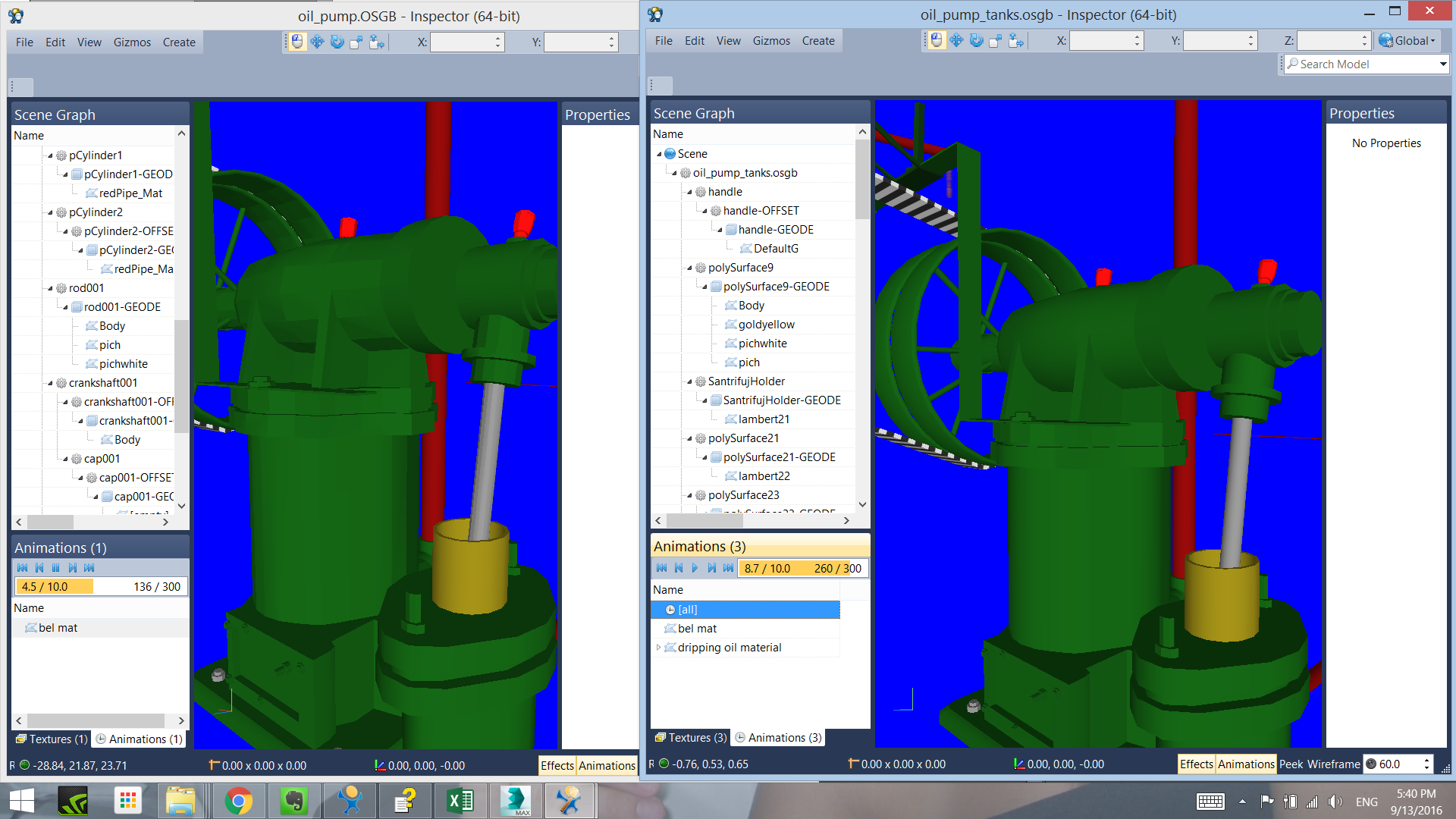

  • When comparing the two models within inspector, the main difference I see, other than texture changes, are that the old model has much more pronounced normals than the new one. (see inspector-normals.jpg)
  • The geometry in the Max model is using explicit normals, which appear in green if an "Edit Normals" modifier is applied. (see edit-normals.jpg)
ID:	822   Click image for larger version

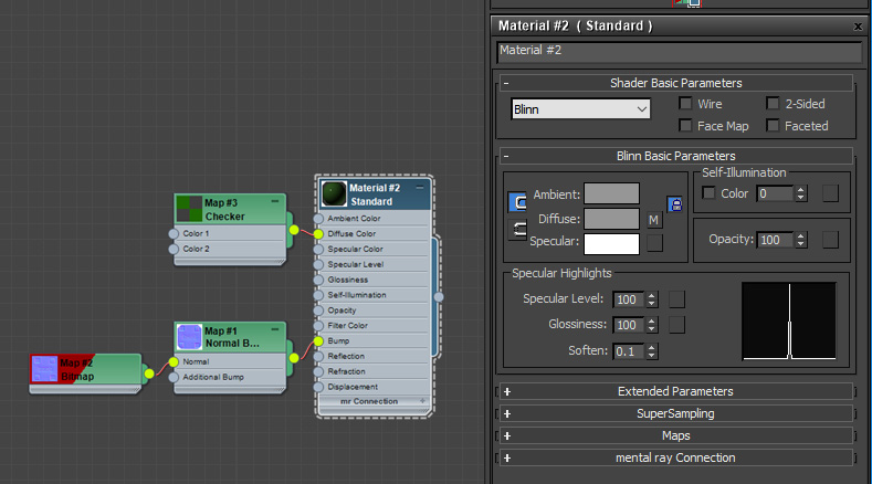

ID:	833   Click image for larger version
