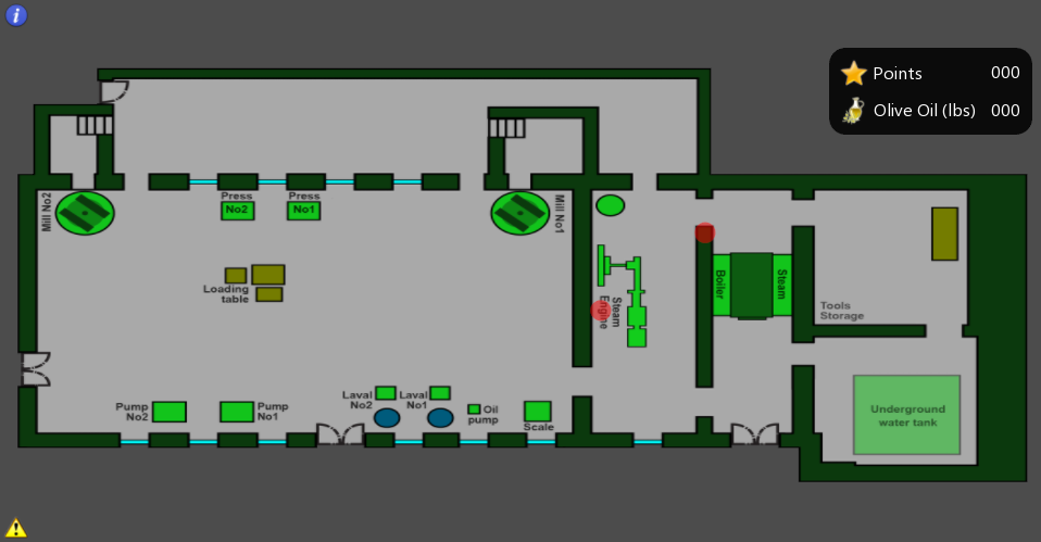

I am using a piece of code from Vizard's onTheFly.py example (see below) to create some dots on a map. The dots are created normally when run from within the module ('__main__'), but become square when the module is called from another module (see images)! Absolutely nothing changes in the way the code is called, so it makes no sense to me why this might happen. Seems like a bug.

Is one script enabling multisampling and the other not? Without multsampling enabled, points will usually be rendered as squares.

Easy fix! I knew it would be a piece of cake for you, farshizzo!
