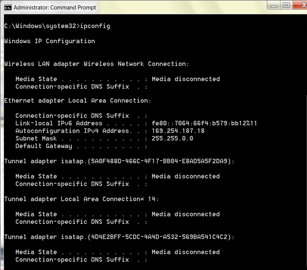

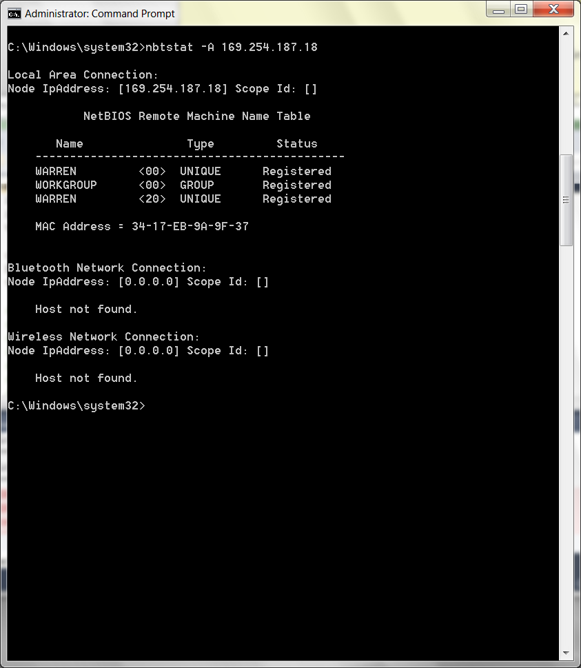

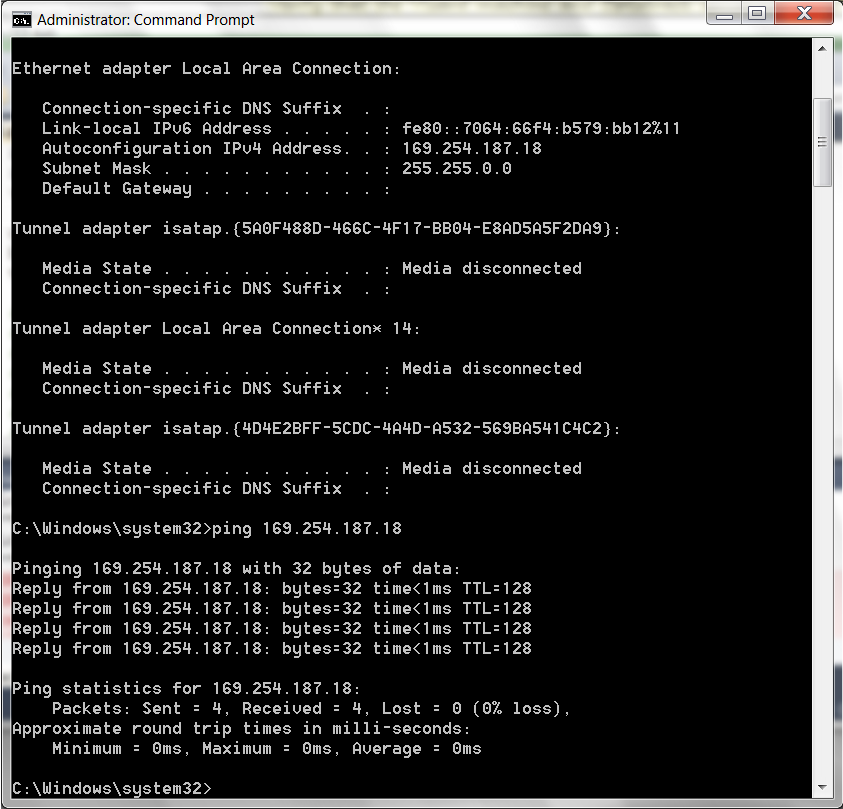

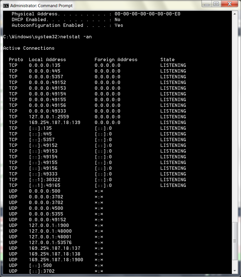

I have disabled any firewalls and antivirus as you suggested. I have also checked the IP address I had inserted and if the Optotrak server and the Vizard machine can ping each other. It seems everything is correct in the information I am typing. I am attaching some screenshots about of my cmd window. Can you control if there is anything wrong or weird in what I am doing?
