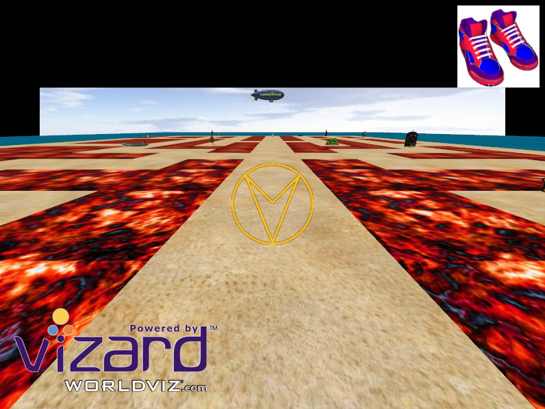

I create sky using the following lines
env = viz.addEnvironmentMap('sky.jpg')
sky = viz.addCustomNode('skydome.dlc')
sky.texture(env)
The problem is in some angles the sky is not covering the horizon. Here I have attached three screen shots showing the situation. When you go forward it covers more. It is like this for only some angles. When you turn back it covers the whole horizon. Would you please let me know how to solve it? Thanks.
Greetings
Amir

It may be an issue with clipping. Try increasing the far clipping distance:
viz.MainWindow.clip(0.5, 2000)
Old 07-07-2014, 04:57 PM
javadi javadi is offline
Join Date: Mar 2013
Location: London
Posts: 33
Great. Thanks. It works. :-)
