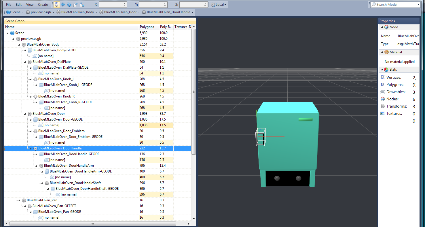

I'm getting a bit confused when it comes to what is shown me in the vizard inspector vs. what I am actually altering in my vizard code.
For instance, take the image attached ( yes I am using Vizard 5 but I assume nothign changes with how scene graphs hierarchies function I felt it more pertinent to throw this in Vizard 4's forum).
I have watched your video tutorial, however it does not cover hierarchies with more than 1 parented object, which is what I am dealing with.
I have a blue box with a door, latch and handle, each parented (linked) in Max with their pivots placed where I want their rotations to be performed. And I have reset the xForm many times.
When I view this in the inspector, I can see the transform node labeled 'BlueMLabOven_LabHandle' and when I select the transform I am able to pivot about the expected location and the child comes along for the ride as I'd expect.
Same thing with the door labeled 'BlueMLabOven_Door', when I rotate about the transform in the inspector all the child components come along and the pivot is about the correct location.

Calling node.getChild() will insert a transform above the specified sub-node. From the documentation:
This command will slightly modify the underlying scene graph of the node by inserting a transform above the specified child node.
So all transformation will then be applied to the newly inserted transform.
In Vizard 5 you can use the node.getTransform() command to get a handle to the specified sub-transform node. Transforming this object should provide similar behavior to transforming the node in Inspector.
