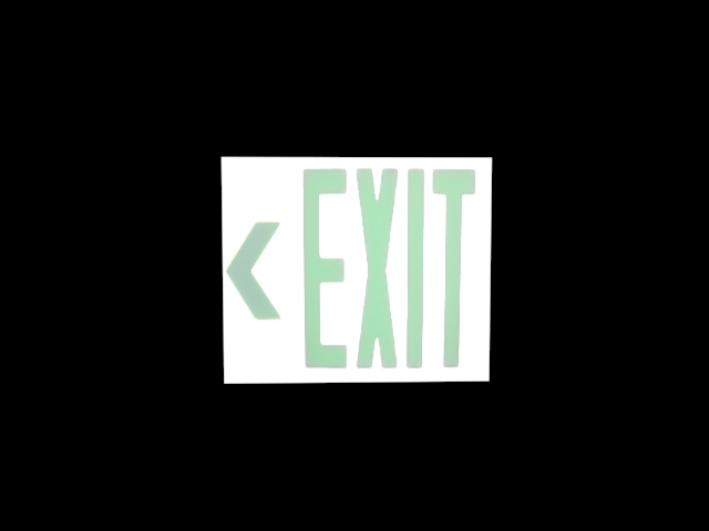

Hi, Having a problem in Vizard, displaying the color of some textures, with either a border or the whole color of the texture has been changed, or noise has been added. I'll attach some SS. One is the Max render, showing what it should look like, the other is Vizard's real time render.

You mentioned bit depth so I compared my texture to other textures in our scene that weren't having the issue. I noticed in photoshop that the Image->Mode-> Bits/channel weren't the same for each texture file. So setting those both to 8 bits/channel fixed the problem. Thanks for the help.
