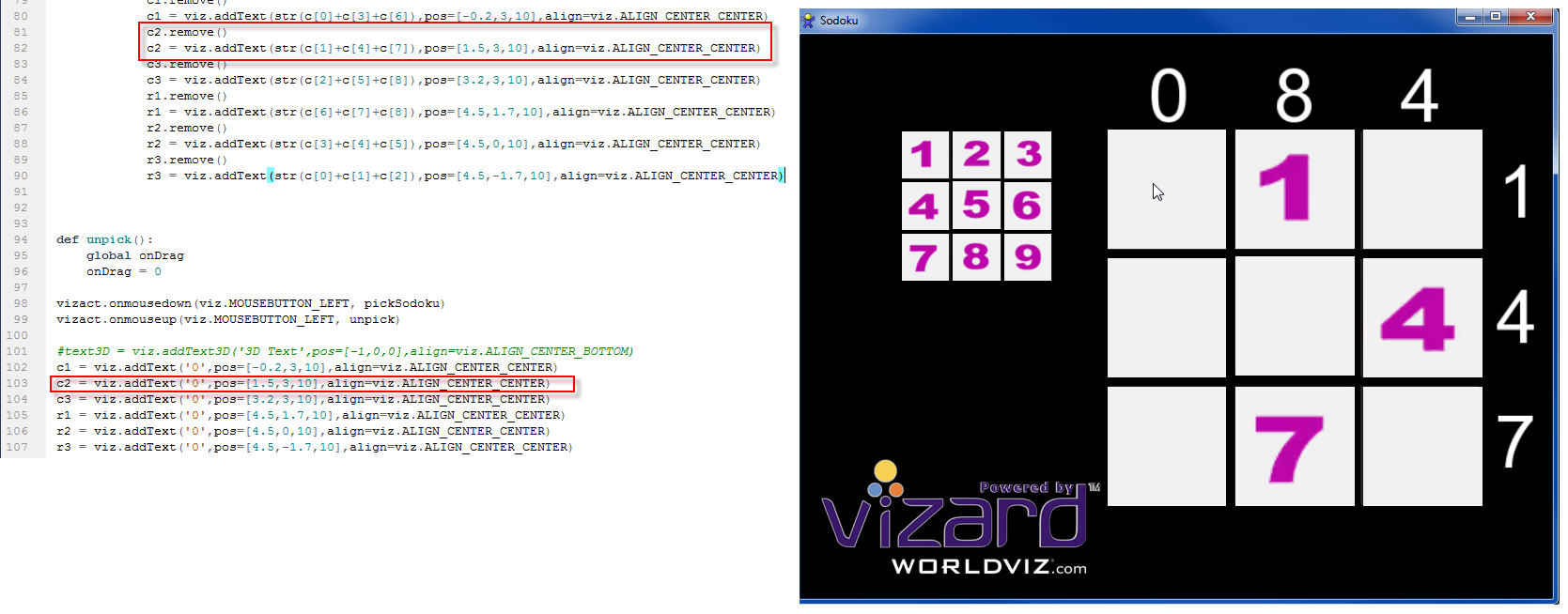

Change 2D text?
When I click a cell, a list of number will appear on the left.
After click on a number on the left it will update to cell.
It will also caculate the total value of each column or each cell.
I could do that now. But the way to do very not so good
I have to remove the text (value of row or column) and add new one.
In other game engine, I could change the text value.
How could I do that in Vizard?

You can use the node.message to dynamically change the text value.
c2.message('new value')
I'd recommend reading through the documentation, especially the Text node basics section.
