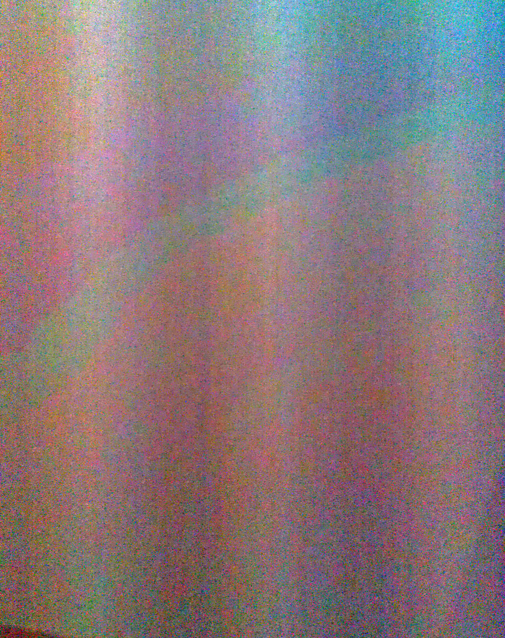

Here is what I hope to be a better image.
A side by side of the original image and an attempt to enhance it.
It is the gradient we are dealing with, where it seems like all the midtones disappear and instead we get a nasty green or pink color in its place.
I know it is very noisy, and I'll try to get a better picture tomorrow with a camera that allows for slower shutter speeds.
~George

To troubleshoot this, do you have the ability to view the same or similar gradient in active stereo independently of Vizard? The fact that you don’t see it without the glasses suggests that it’s a timing issue between the glasses sync and the DLP light engine. I think it’s worth a few tests to see if you replicate the artifact in other tools. Besides using a different 3D renderer for the same scene, you could try a simple 3D stereo picture viewer such as what nVidia provides with their “3D Vision Driver” (see this page for details: http://www.nvidia.com/object/3d-vision-photos.html). For the stereo picture test, I’d suggest just loading the identical smooth gradient in both left and right eyes, engaging active stereo, and viewing with the glasses to see if that also causes the artifact. My prediction is it will.

We spent some time playing with our projector settings and were able to directly modify the severity of the problem. We are going to spend some time trying to identify the optimal ranges to set our projects at, but just playing around with the settings we noticed the effect could completely disappear or become far worse.
We also successfully photographed the issue and I thought I'd post two images in case anyone else has a similar issue in the future.
