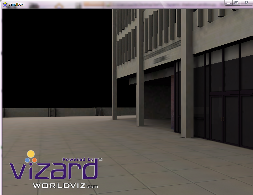

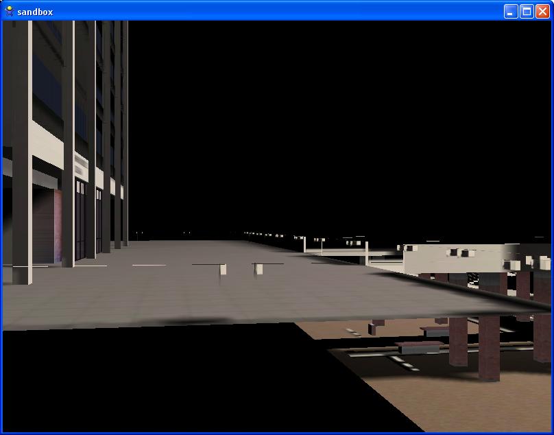

Before, I was building models in Maya, exporting them to FBX, then importing them into Max, baking shadows, and exporting. There was some tweaking involved before baking, and I don't remember exactly what I was doing, but it was working. 2.jpg is the way it ended up and it was absolutely beautiful. It was exactly what I wanted. By the way, the lighting in that image is done with a single skylight.
Then I had to add some stuff to the model. I did that, rebaked all the shadows, and exported. It was a disaster. See 1.jpg for details.

Then I baked and exported everything according to the same tutorial. The result is 1.jpg. Stuff is just randomly disappearing from opacity into transparency. Shadows are wrong, as if there's invisible geometry all over the place casting the shadows.
The lighting in the one that isn't working is the same.
Thank you for reading. Please help.

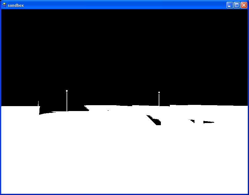

Using both complete map and lighting map methods, I end up with a scene that looks like 3.JPG.
I have a few questions about the new tutorial:
- The light created in the tutorial has a very low multiplier, lower than I've ever used for a key light. I usually just use a multiplier of 1, and that worked before. Why would .3 be better?
- What does the "ambient only" box do?
-The light created in the tutorial is not casting shadows. How are shadows going to be baked if they are not being cast by the light?
- In the export dialog in the tutorial, the "export lights" box is checked but "turn off lighting" is also checked. What does the "turn off lighting" box do?
-I don't have Inspector. Can I download it for free, and will it help with the debugging process?
Here is my script:
behgrnd = viz.add('beh-029g.IVE')
behgrnd.disable(viz.LIGHTING) # the result is still 3.JPG with this commented out

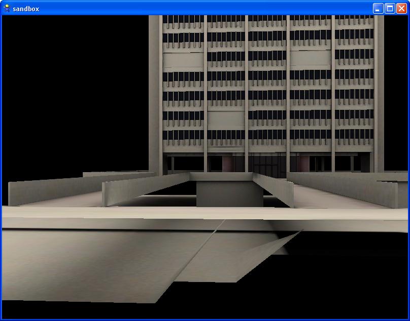

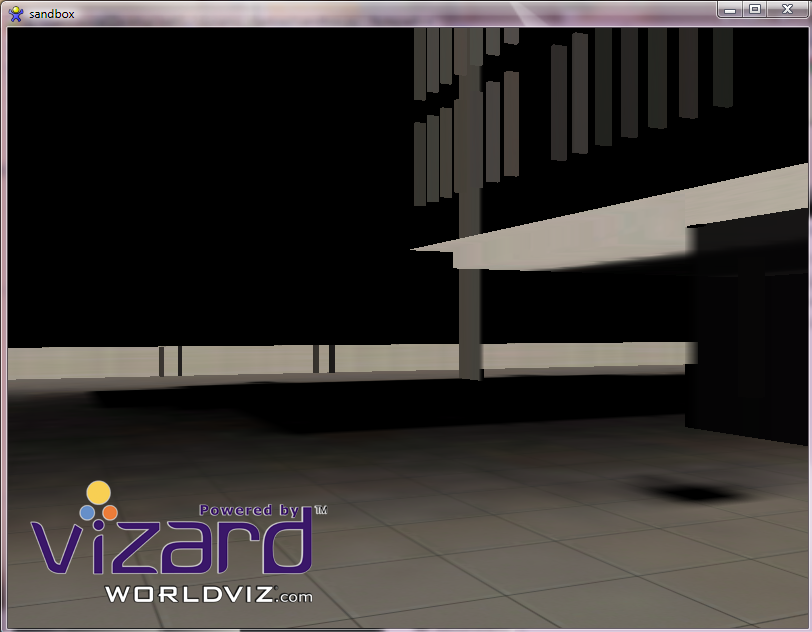

I tested the dynamic shadow thing on an older version of the model with baked shadows.
without.png is what it looks like without dynamic shadows
with.png is what it looks like with dynamic shadows.

...So it looks like that won't be my quick and dirty solution.
The euler in the Shadow.py constructor is set to [0,90,0] by default. If I change
shadow = Shadow.ShadowProjector(size=SHADOW_RES,pos=SHADOW_ POS,area=SHADOW_AREA)
to
shadow = Shadow.ShadowProjector(size=SHADOW_RES,pos=SHADOW_ POS,euler=[30,90,30],area=SHADOW_AREA)
in the tutorial's example.py, nothing changes. Can dynamic shadows only be cast directly from above?
