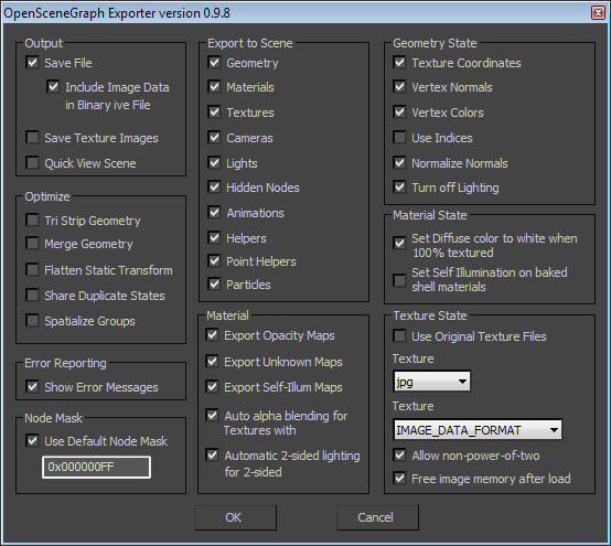

Hi Yamaha,
There seems to be a misunderstanding here. In 3ds max, maps and materials are separete things. Maps/textures are contained within materials. For exporting, you need to be using the "Standard" material type with your texture in the Diffuse, Self-Illumination or Reflection slot.
I've attached a screenshot of the recommend OSG Exporter settings.
