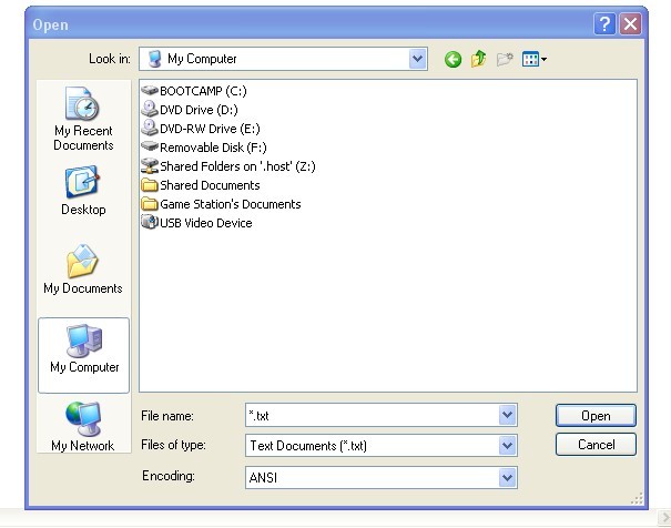

Is there any open file GUI
Can I build a GUI in vizard, like below, that allow user to open and choose some files and import them into vizard?

I mean build a button, and when click the button, it can call an open file GUI in which people can browse and choose files to be open?

There's an example over in the Vizard 2.5 forum. Here's a link to it:http://forum.worldviz.com/showthread...light=win32gui
I've tried it under Vizard 3 and it works, no problem.
