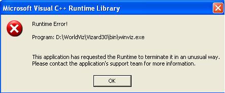

I am having a problem while exporting my objects from 3dsmax to vizard.
the texture format chosen is PNG and the texture compression is S3TC_DXT3.
the problem is when I load my objects in vizard, I have an error message for winviz.exe, saying "Run Time error ". do you have an idea of what could be the problem.

Does the error occur when you don't use texture compression? Would it be possible to send me a sample MAX file that produces this error? My email is lashkari@worldviz.com

thanks for the reply,
I was done with the export to vizard. and in an other version I used the tga as texture format, and S3TC_DXT5. and I didn't have that problem.
I change to PNG and S3TC_DXT3.
when I load the objects in vizard have the problems. and I do use texture compression for the export.
