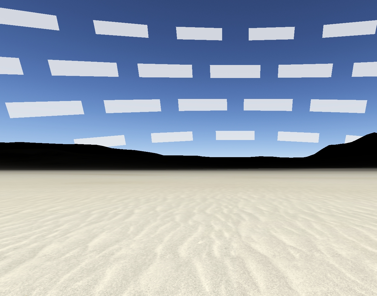

Hi Could someone help me out? I just install the fall edition and I 'm having this black fog wierdness. Seems like I can't get rid of this.
I started with;
headLight = viz.MainView.getHeadLight()
headLight.disable()
I loaded the terrain like;
     #Load 3D virtual Environment
     self.terrain = viz.add('data/world/terrain.osg')
     self.terrain.setScale([Globals.SCALE, Globals.SCALE, Globals.SCALE])
     #self.terrain.disable(viz.LIGHTING)
     self.terrain.disable(viz.FOG)
     self.terrain.enable(viz.CULL_FACE)
     self.terrain.enable(viz.CULLING)
With Light or No Light, I get same result. What did I do wrong?
Please see attached screenshot.
wierdFog1 - how the scene looks from starting point
wierdFog2 - how the scene looks from 50-100 units from above starting point
Kind Regards,
Iwan

Red face seems to be a solution...
I changed the fog type from none to exponential, and it seems to brighten things up. I could be mistaken, but If I remember correctly, setting the fog to none should disable the Fog, no?

Talking My Apology...
My Apology...
The problem lies in the shader program. It's all fixed now.
