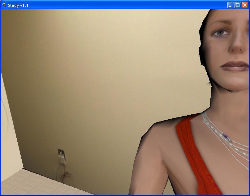

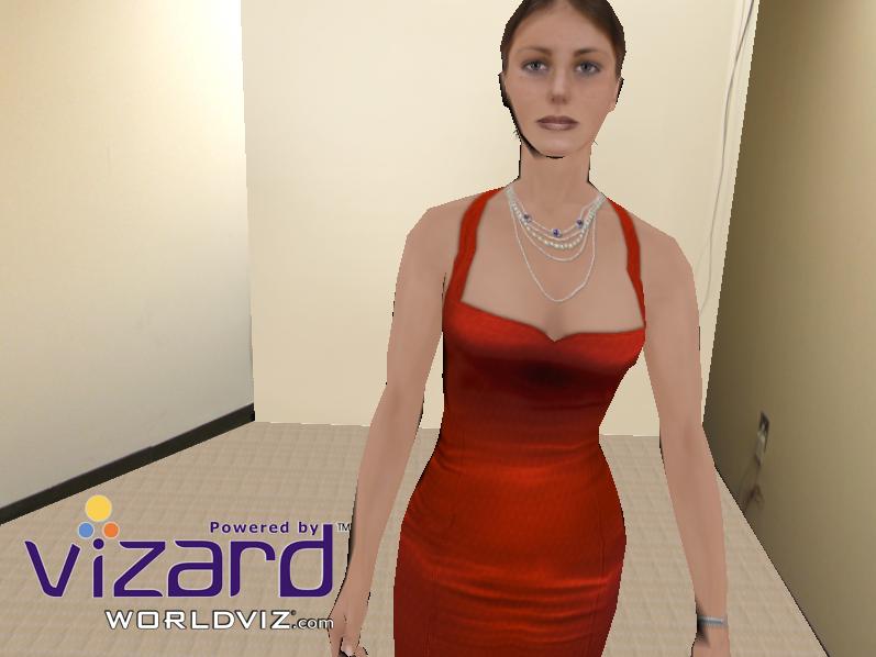

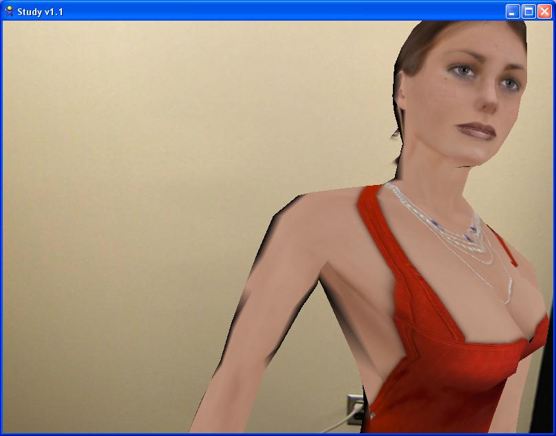

Hey guys,
I'm using several of the Rocketbox Complete Character avatars (medium polgon version). When rendering the avatars in Vizard 3.0, black areas spontaneously appear on the edges of their bodies (see screenshots.) It seems that these might be rendered shadows, but they look unnatural and jumpy. I get the same dark spots on both the HMD and the computer monitor, regardless of whether or not the avatar is animated.
What is the reason for the dark edges on the avatars? Also, if these are in fact shadows, is there a way to disable this feature?

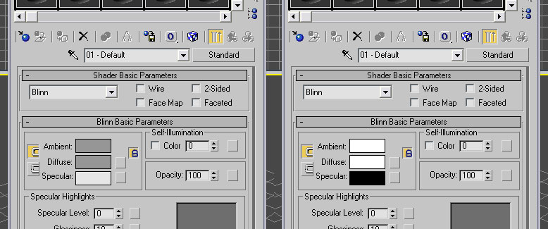

Hi v-jbinney.
What you are seeing is a bug with the way cal3d handles specular highlights. You can fix this problem by changing the specular color to black (it's white by default), as in the attachment, or by increasing the number next to specular level.
Basically, if you want something to look shiny, leave the color as white, and crank up the number next to the specular level, and if you want something be matte, leave the number at zero and set the specular color to black.

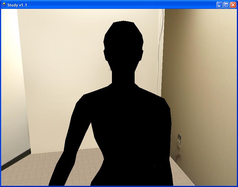

Thanks for your suggestions. However, when I tried implementing them, I had some peculiar results.
When I changed the specular color to black and re-exported all the Cal3D files, Vizard rendered the avatar as a completely black object:

Old 10-09-2007, 10:14 AM
Vizard does not have a "shadow" feature. The problem is that the avatar material is not using ideal values. Try the following in your script:
avatar.color(1,1,1)
avatar.ambient(0.6,0.6,0.6)
avatar.emissive(0,0,0)
avatar.specular(0,0,0)
These are the values the default avatars use.
