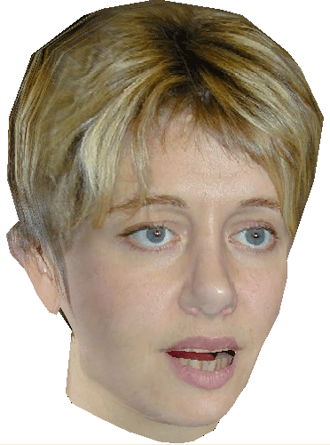

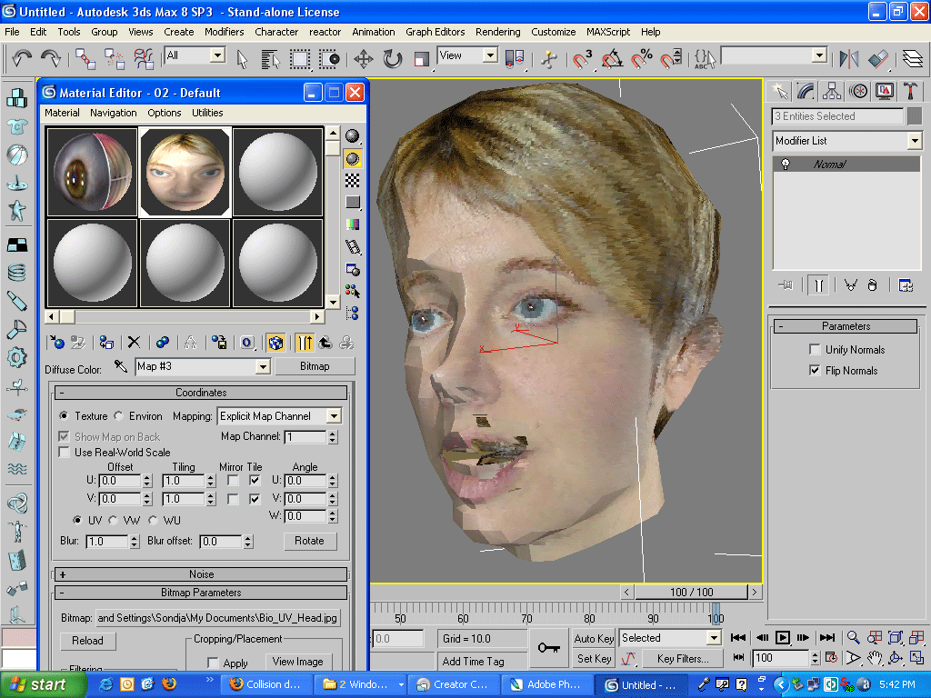

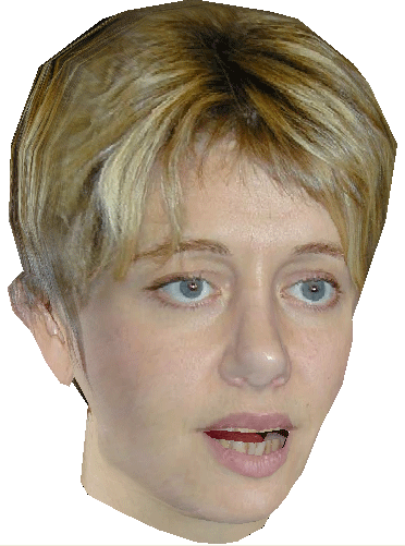

Hi, I'm working on heads avatars under vizard 3. Like it's says in the help manuel, I have to use 3DMeNoW to create the avatar head. That level is ok. But when I imported on 3DS Max to convert it in VRML97 format, the textures for the inside mouth don't show (view attachement) when I'm doing the morphings !!! My question is how to apply the bio_texture and the Ett_texture so that the head textured well on PeopleMaker and Vizard 3 beta ? I can't do a sub-object (3DS MAX 8) on the head because all of it made one mesh !!!.

Are you using PeopleMaker as part of your workflow? If so, can you not select the mouth portion within PeopleMaker and select "Flip polygon order" to make the mouth visible?
If that doesn't work, try applying a .disable(viz.CULL_FACE) method to your face object from the Vizard script. This will disable backface culling over the whole face making all polys always visible.
