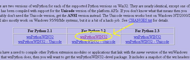

Old 06-05-2003, 06:08 PM
Hi Kim,
I'm pretty sure the problem is that you installed the unicode version of wxPython. Uninstall wxPython then download and install the normal version. Here's a screenshot of the download page, I highlighted the version you should download. After that everything should work fine.
-- Farshid

I reinstalled wxPython based on your last instructions, and things seem to be working properly now. So I must have downloaded the unicode version by mistake (as you suggested).
