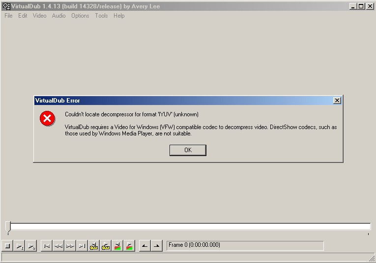

I am also interested in recording video of real-time motion simulations in Vizard. I used Fraps 1.9d to record 5-10 seconds of video in a "viz.go(viz.NICE)"-sized window. The .avi file is saved just fine, and similar to above postings, I am not able to run it in Windows Media Player. However, when I try to open it in VirtualDub 1.4.13 to re-save as an .avi file, I also get an error message (see attached screenshot).
So, I cannot re-save the uncompressed video file as a .avi file using VirtualDub before converting to MPEG1 or 2.
Any idea why this is happening?

Fraps support web page used to talk about this problem and suggested how to resolve this. That page doesn't appear to be there anymore, perhaps because they have a version you pay for now and it's resolved in it. Don't know.
Our recommendation right now is to start using SnagIt. It's worth the small price. It's also fully functional for 30 days free.
