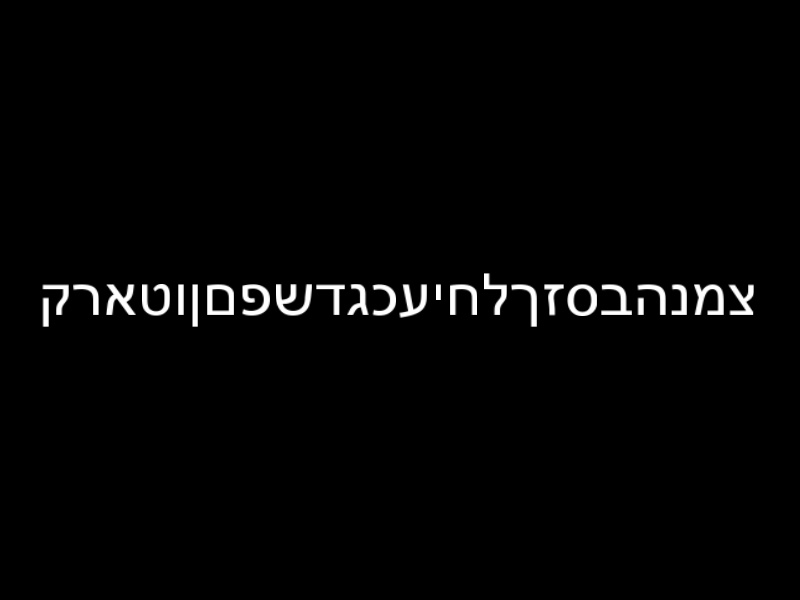

I installed hebrew on my computer and ran the following script and it displayed the attached image. Is the text in the image real hebrew?
# coding: UTF-8
text = viz.addText('קראטוןםפשדגכעיחלךזסבהנמצ',viz.SCREEN,pos=(0.5,0.5,0),align=viz.TEXT_CENTER_CENTER)

The text in the image is real hebrew indeed, but when i run your code
on my computer (after copy pasting) i still don't get the right characters...

when using the code written before - it reverses the order of the letters ( which can also be seen in the jpg you attached )
