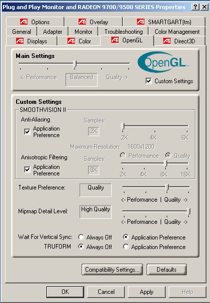

Yes, all textures are affected (at least those in the tutorial examples). Here is a screen shot of the OpenGL settings window for the ATI Radeon 9700/9500 card.
[QUOTE] There should be an option "Wait for Vertical Sync", you want to set this to "Always On".
Clearly, there is no "Always On" option, hence my confusion. The settings shown in the attachment are the defaults.

Which version of the ATI driver do you have? Also, what OS are you using? Over here we have an ATI RADEON 9800 on WinXP and textures show up fine. Vertical sync works fine also, and we even have the "Always On" option. We are using the Catalyst 4.2 drivers downloaded directly from ATI's website. If you aren't using the latest drivers you might want to try that first.
