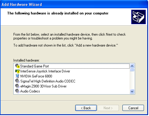

I followed the instructions and apparently there is some kind of error. I've attached a screenshot that shows the exclamation marks that come up next to the standard game port and the Intersense Joystick Interface Driver. Has anyone else encountered this and does anyone know of a fix.
