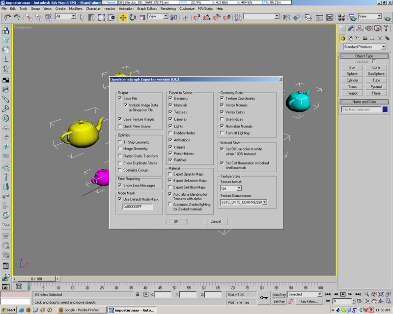

Export Dialog screenshot
Hello Farshi:
I send you a screenshot of the export diag.
See ya !!
viz.FOREVER
D.

Old 07-06-2007, 09:10 AM
Everything looks good. I'm not sure what is going on. I'm going to have our modeler test this out to see if it works here.
