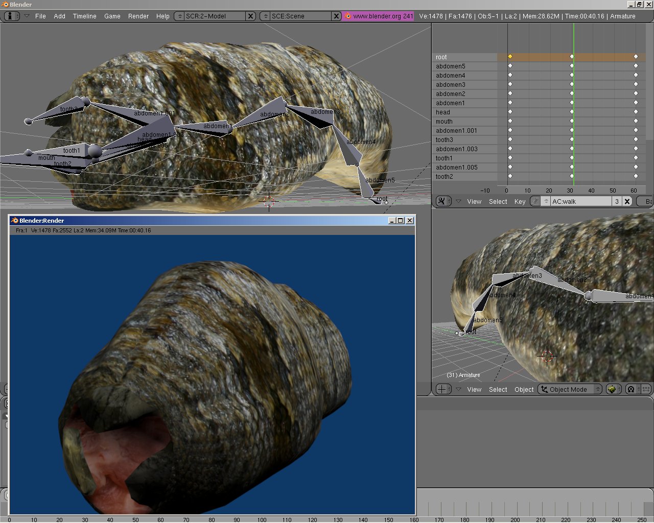

Unhappy another progress..... (screenshot attached)
Here's another progress...
I managed to successfully export a model from blender to cal3d. the current cal3d exporter (v.0.9) that comes with blender is broken. There's an updated version in blender forum (v1.1)
By the time I loaded the .cfg in Vizard2.5 trial.. it crashed. I look in the .cfg file the exporter genereated.. and everything seems normal. The model which I created is very simple; a small worm wth only 6-9 bones, 1400 polys.
I tried these following formats with some basic animations;
...md2 ... vizard fails to load the model.
...OSG ... vizard only loads the model.. no animation
...flt ... Vizard loaded up ok, but displayed nothing...
...cfg (cal3d from blender) ... vizard crashed...
...ac3d format ...vizard loaded the model ok.. no animations
...lwo ...vizard reported something error with the file.. did not load model
...3ds ...vizard refused to load.. there's is something fishly about blender's 3ds exporter...
Well... that's the update for today... thanks for reading. I provided a screenshot of my model with the skeletons visible. Then again.... does vizard only import bipeds?
Regards,
k_Iwan
