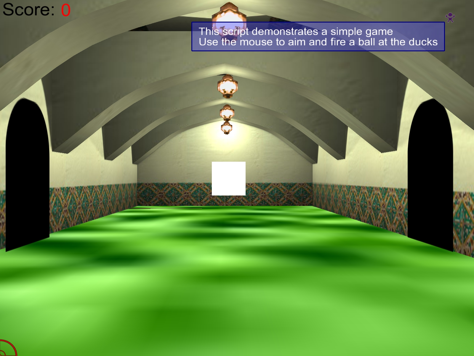

The room I created work correctly when I use the 3D screen. On the other hand, when I run the same script ONLY by using my laptop I do not see the same room clear (in bidimensional space), instead I still see the room with double effect, which is the one required for 3D. Is there any way to navigate within that room without 3D monitor and have a "clear" image of it?

viz.screencapture('giuseppe_screenshot.jpg')
After you run the script it will create a file called giuseppe_screenshot.jpg in the directory of your script. Can you post this image file on the forum so I can understand exactly what you are seeing. Thanks.

I did change the scripts as you suggested. Nothing changed in the way it lloks on my laptop-screen, each image is double. On the contrary, in the image you asked to take it looks perfect, as I really would lke to look (i guess because a screen shot takes just on single frame). I am attaching in a next reply another file where instead you can see how your suare white box looks like (I made it with photoshop to give you an idea; i only changed the white box, but everything else appear double). hope this can help. and thank you so much for your patient.

From the image you photoshopped, it looks like you are enabling the viz.INTERLACE stereo mode in your script. If you are not specifying this option in your script, then have you installed any 3rd party stereo drivers on your compter?

I disactivated viz.INTERLACE after set viz.FULLSCREEN. However, below the first line (import viz) there is import vizmat, which I do not know what is.
yes, I have NVIDIA GeForce Go 7900 GS which runs the laptop monitor.

THAT WAS THE PROBLEM. I disabled the stereo modo and it works. thank you so much and sorry about all this. now I know I can use Vizard, so I'll probably be back soon with more question on how to do things etc..
