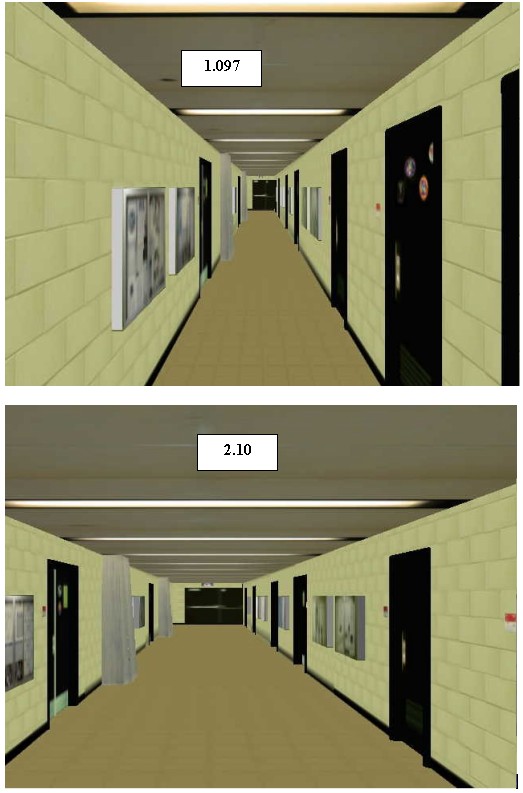

Attached are left eye images of the identical script run viz.go(viz.STEREO | viz.HMD) under versions 1.097 and 2.10.
Any thoughts as to why the distortion occurs?

This is a problem that has already been fixed in 2.11. In the meantime you can issue the following command to fix the FOV:
viz.fov(40,2.6)
Sorry for the inconvenience
