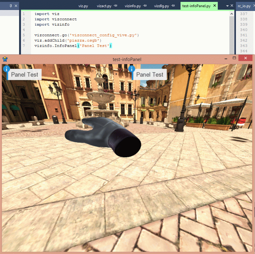

Hi there,
I'm trying to create an InfoPanel from the default vizinfo.InfoPanel class. It runs fine in desktop mode, but with an HMD vizconnect running the InfoPanel is being drawn twice on the monitor. Almost as if the InfoPanel is being rendered in stereo mode, and the rest of the scene is being rendered with the left eye on the monitor.
The purpose of this is to create an "Instructor View" on the monitor with controls that are only visible to the instructor.

seowen1 seowen1 is offline
Join Date: May 2017
Posts: 17
No, I am still seeing it rendered twice. I've uploaded a screenshot of what I'm seeing when I run your code.
Thank you for looking into this, it's really becoming a problem.

Old 11-06-2018, 09:32 PM
Add the following line of code to render the panel only once:
panel.renderToEye(viz.LEFT_EYE)
Old 11-07-2018, 08:55 AM
Join Date: May 2017
Posts: 17
That did the trick! Thank you!
