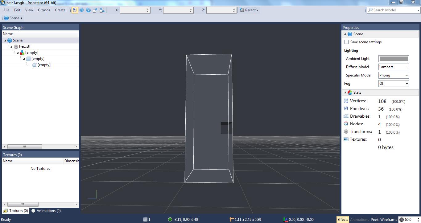

The problem is not that the boxes drop but the osgb i imported
The Heizung Attribute is a STL data i implemented and edited it with the inspector. The boxes i implemented work perfectly fine they drop and lay staticly on the ground after they fell but the heiz1.osgb (a picture of it is attached) just drops over and i dont know why it does that in first place when i enable the phisycs

I think i found the problem. Like the Screenshot shows, the center of gravity is at the down left front corner of the object. so i think the physics apply at that point and thats why the object drops so weird on the ground.
I found sth about the pivot point in the documentary which defines the the turn axe of the object. Does that point also determines where the physics apply?
So i just had to move the point in the screenshot to the center of the object and i guess the problem would be solved. I found the solution in the documentary but all these functions are not shown in my instructor, so my question is how do i move that center of gravity?

The node.setCenter command will change the object's center of rotation. I'm not sure but it might also help in this case.
