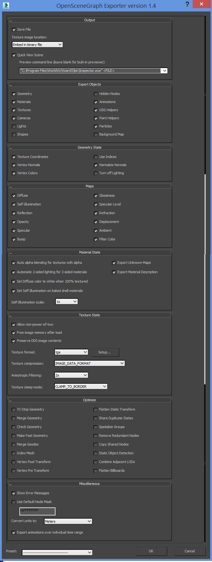

I'm trying to add a light map and a bump map from 3ds Max into Vizard by using osgb. My light map is not displayed in vizard, but it is included as a texture. If i am using a complete map it is working, but then the resolution is not very good. Can anyone help me?

What do you have set for the target map slot? Can you attach screenshots of the OSG export settings?

The target map slot for my lighting map is self-illumination.

Hi Stakkie,
To fully take advantage of shaders (to use the modern workflow diffuse/spec/normals/etc.) you'll want to be using the vizfx workflow. For this workflow, the lightmap should go in the Ambient slot. The Self-Illumination slot is currently used for glow maps.
Check out this reference to see what is supported:
http://docs.worldviz.com/vizard/Shaders_3DS_Max.htm
For the programming side of things, the main difference is adding a model with vizfx.addChild('model.osgb') instead of using viz.add('model.osgb').
The old workflow is mainly useful when performance is considered more important than aesthetics, such as with unoptimized multi-million polygon architecture models.

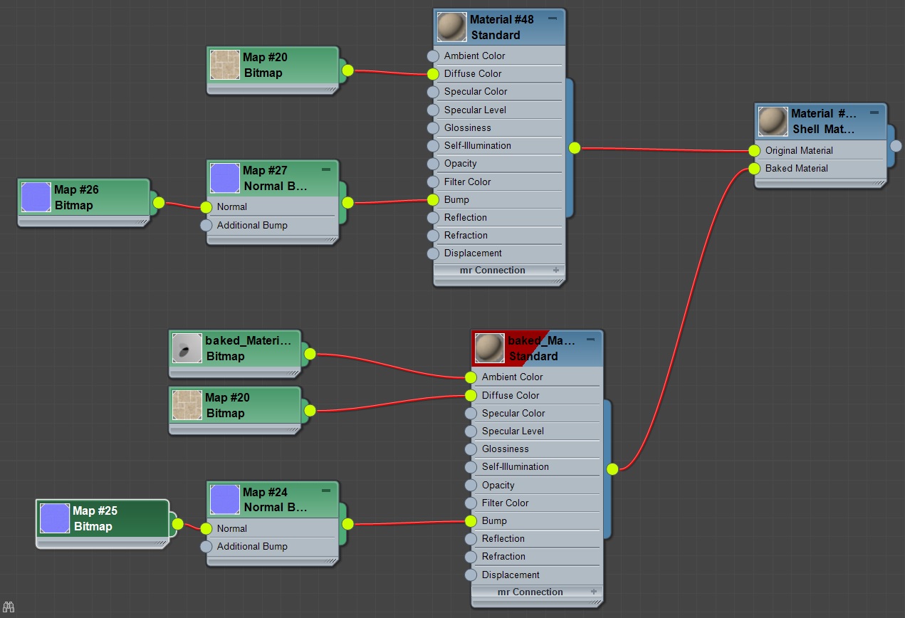

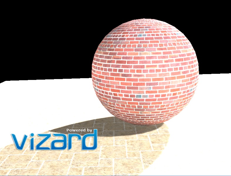

Hi Veleno,
Now my diffuse color is not showed in vizard anymore.
What am I doing wrong?
I also added my Slate Material Editor printscreen of 3DS Max, maybe that gives a more clear view of what i did (wrong).

Old 01-13-2017, 12:49 PM
Post Exposure Sample Script
Nothing wrong with your setup - your scene is just over exposed. The default exposure looks something like Diffuse * (Lightmap * 2), where lightmap values are interpreted on a 0 to 1 scale (e.g. 255 in photoshop reads as 1.0 to Vizard). This means that a neutral exposure is 50% gray.
As long as none of your brights are clipped in your lightmap you shouldn't need to rebake - exposure can be adjusted in Vizard by using a post process shader, like this:

That should help you out. Please also note that inspector does not currently have a way to adjust exposure or add other post effects on its own. You may also want to disable Inspector's default sun node or disable realtime lighting on your model if it's making it difficult to accurately see what's going on in your model.
On a side note, lightmaps are treated as part of the lighting model in the vizfx shader so they are compatible with realtime lights.
