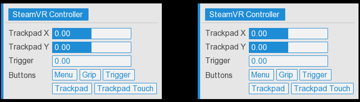

Old 04-20-2021, 04:10 AM
Roy Roy is offline
Join Date: Dec 2019
Posts: 12
I have the same problem.
Although the controller preferences in steamVR is fine, it doesn't work in vizard program.
When I write codes as below,
for controller in steamvr.getControllerList():
	print 'vive controller connected'
vizconfig.register(controller)
vizconfig.getConfigWindow().setWindowVisible(True)
for device in steamvr.getControllerList(): #check VR device
	print device
it says
steamvr.dle              	SteamVR Extension
__builtin__.SteamVRController(1)
vizconfig shows the window as attached image, but any keys don't work. Also, I tried viztask.waitSensorDown(controller, steamvr.BUTTON_TRACKPAD), but it never work.

Old 04-21-2021, 07:40 AM
sado_rabaudi sado_rabaudi is offline
Join Date: Jul 2016
Posts: 42
Hi Roy,
If you go to tools- vizconnect and choose the SteamVR preset, then go to start page- advanced- inputs do you see a green button or red x next to the r_hand_input and l_hand_input?
Also, the controllers are showing as lit up in SteamVR?
