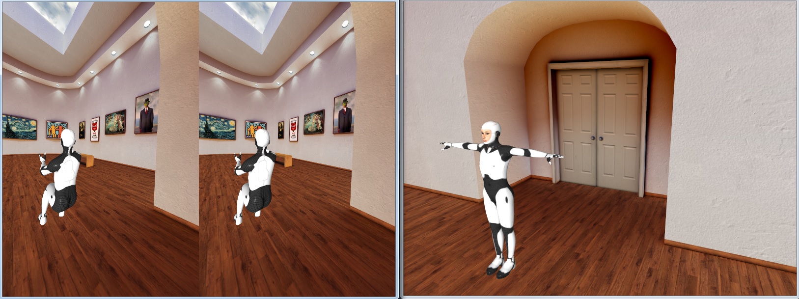

Thanks Jeff, with your help I managed to get the second window to show up and made the stationary view follow a tracker. However, there's a problem with the live character. While it's correctly shown in the view of the oculus rift, the character just stands in its T-pose in the other client window as you can see in the attached picture.
What's the workaround for that? Do I need to load a another Live Characters Device instance into MotionBuilder and set another port or something?
Or is what's happening in one client simply not shared by the others (»Note: Co-presence is not supported on a local cluster.«)?
So I would need to connect another machine to the network and start a vizard client to have 2 different windows into the same shared world?

Are you adding the avatar and applying the Live Characters animator in vizconnect? If so, try adding the avatar and apply the Live Characters data to it in the script that imports the configuration file.

I'm adding the live character in script with this line:
live_char = vizmocap.LiveCharacter('localhost', 8050, 8055, model=avatar)
I have to switch the avatar model in the experiment, so I didn't use vizconnect for that. I simply do this with
live_char.removeModel(avatar)
avatar.remove()
avatar = get_avatar_by_type(objective.avatar_type, participant.height) #own function
live_char.addModel(avatar)
But well, I guess, the switch wouldn't have anything to do with the synchronization problem between the 2 windows, because it's not working even before the switch.
When I get to book the lab again, I'll try the client on an extra laptop and change 'localhost' to the address of the machine where the live characters plugin is running.
