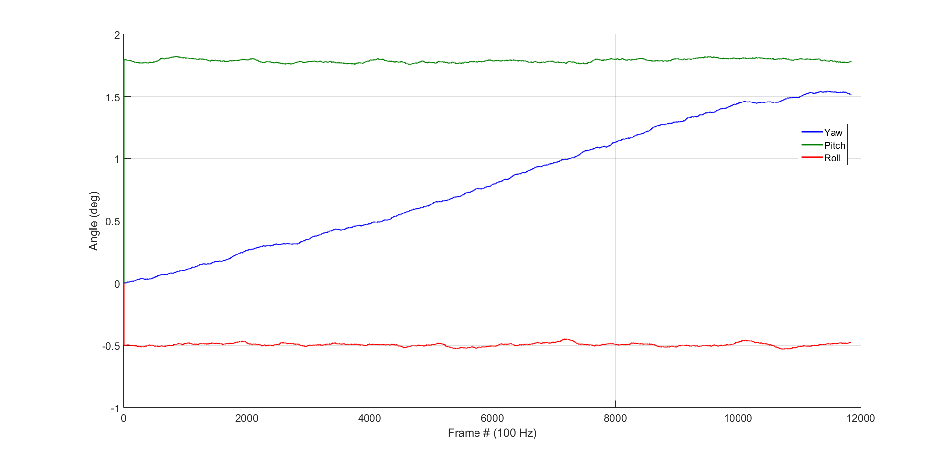

The yaw drift is still present however. Any advice on correcting for it? Should I try and re-calibrate the magnetometer? Apply a stronger magnetic field?

I would not advice you to apply a strong magnetic field. This could potentially do more harm than good.
Are you using the Oculus together with the camera (which is supposed to go on top of the monitor)? If not, the slow yaw drift is a normal behavior of the Oculus and can not be corrected.
We are having the same issue here, as we are using the Oculus together with a Vicon Tracking System inside a large room. Thus, we cannot use the camera and we get a slow yaw drift (1-4deg/min) whenever the Oculus is not in motion.

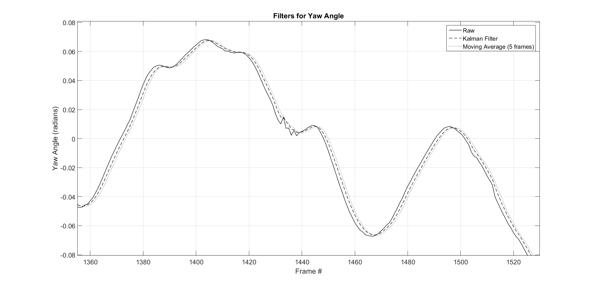

optical tracking filters
For pure optical tracking we experience some "jitter" as you say. I tried two types of filters, a kalman and a moving average with a narrow time window to avoid lag.
Our system is Nexus 2.2.3 with Vizard 5, there are lots of variables within the Nexus system parameters alone that could contribute to how noisy your data is. I've attached a graph of what my filters do to the raw data. I decided the kalman was the best compromise between smooth tracking and minimum lag. The experience isn't too bad but not as nice as the gyros.

Thanks for sharing your results. Looks interesting, we might consider implementing a kalman filter to the yaw data. Are you using your own implementation or is the filtering done by the Nexus software package?

Kalman Filter for Euler Angles and Position data
I had to implement my own filter, Nexus does not have options for a real time filter (although we use 7 markers on the HMD, Nexus 2 in kinematic fit mode will use all available markers on the segment to compute the best fit position and orientation, so the more markers the smoother the result). I'll share the basics here, in case anyone is interested. First, I want to give credit where it is due, most of my code is adapted from this example: http://arxiv.org/ftp/arxiv/papers/1204/1204.0375.pdf
My model is basically to assume that at each iteration, the orientation and position has not changed from the last iteration. This is a really simple model and easy to implement and has some nice characteristics (no overshoot or ripple). I tuned the filter's smoothing and time-lag response by altering the model and measurement noise covariance parameters (not sure if this is the legitimate way to tune a Kalman filter).
