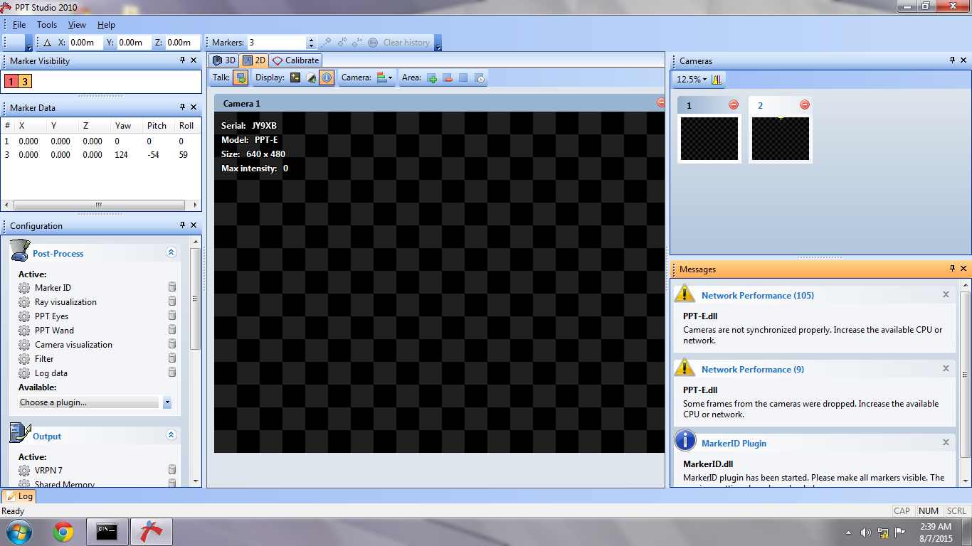

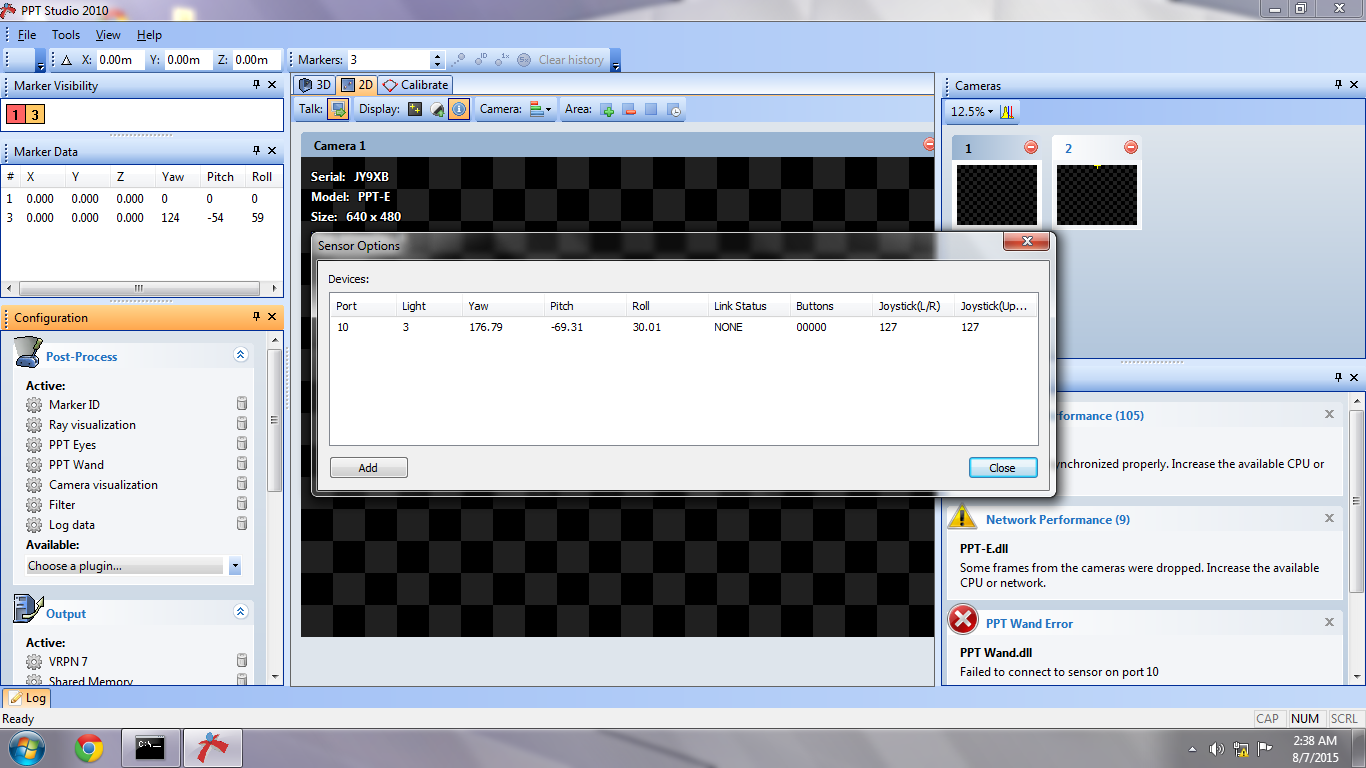

Is the orientation data not showing up in the marker data pane of PPT Studio. Can you attach screenshots of the entire PPT Studio window, the configuration pane, and the marker data pane?

Screen Shot1:Clicking on PPT Eyes Plugin..opens up the window(Not getting orientation Data)
Screen Shot2:Clicking on PPT Wand opens upo the Window(Working fine and getting yaw,pitch,roll but now x,y,z)
Screen Shot3:Screen Shot of PPT Studio

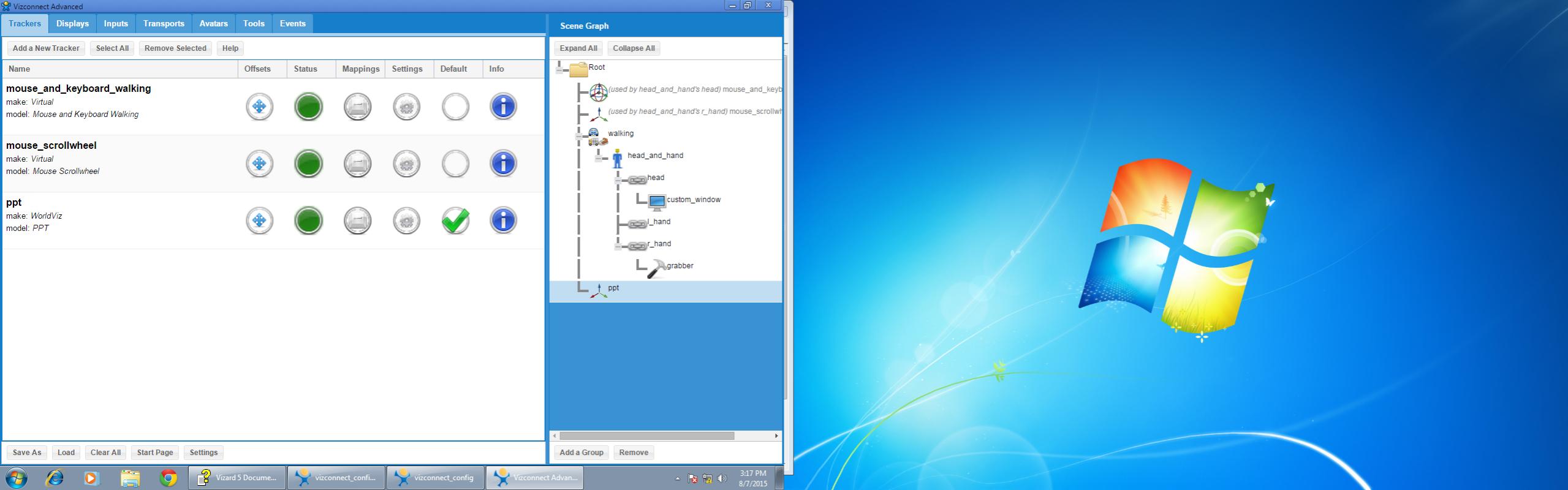

Screen Shot4: PPT Setting for PPT Eyes in Vizconnect..on vizard running machine(IP and Marker Id as '1' as mentioned in the Marker data pane..
(As per PPT Specification:Two markers of 3 D glasses are combined to Single Marker Id as '1')
Screen Shot5: Vizard Running Machine VizConnect Setup(In which i have added the 3D Glasses as a normal PPT Tracker..as suggested)

For post-process plug-in you should only need:
Marker ID
PPT Eyes
PPT Wand
If you're connecting the PPT wand to the Vizard machine, you should not have the PPT wand plug-in in PPT Studio. The wand orientation and analog/button data can be read directly in Vizard using the wand local options under tracker and inputs in vizconnect.
There should be 3 markers being used. 1 and 2 are for the eyes. 3 is for the wand. The PPT Eyes plug-in should specify markers 1 and 2, not 1 and 3. PPT Eyes will combine 1 and 2 into just marker 1 with orientation.
The screenshot shows the cameras are not calibrated. Follow the instructions in the PPT documentation to calibrate.
In vizconnect, you'll want to connect to 2 PPT trackers, one for the eyes and one for the wand. The preset option for cornercavern should already have it set like that. However, the preset assumes the wand is connected directly to Vizard for orientation data and input data. You can change those options in the advanced configuration if you need to have the wand connected through PPT Studio.
