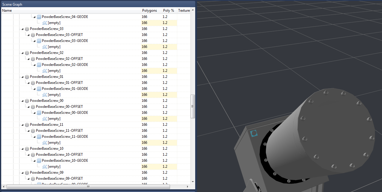

In the inspector, the geometry node takes on the name of the material as seen in the attachment. Therefore, all the objects have the same geometry node name.
I wanted the intersection test to detect each object independently of one another, but all I get is the following on everything I click on:
intersection: __main__.VRC_Auto(1)
intersection: VRC_Auto_M
Now, in the case of a different object with no materials attached, I get the geode returned to me instead. And I am able to easily delineate between the objects by the name and when I perform an intersection I can make all the special events ( such as activate animations happen) just fine. (see the second image).

The intersection test returns the lowest level sub-node in the scene hierarchy. To determine the name of the node above the geometry node set computePath to True when you call the viz.intersect command. The name_path attribute of the returned viz.Intersect object contains a list of sub-node names representing the full path to the intersected object within the scene hierarchy.
