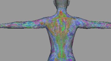

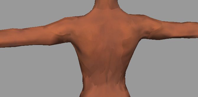

[QUOTE=Maia;13615]Hi,
OK, I tried in Customize -> Preferences -> Gamma and LUT disabled. Is it the right to do that ?
It is better than with Enabled Gamma correction but the texture seems very strange, like a something checkerboard ... (see attached files).
Cheers,
ID:	483   Click image for larger version
ID:	485   Click image for larger version
