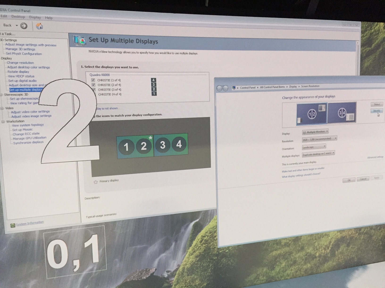

Looking for information on how to setup a four wall CAVE that has a cluster with a Master and two clients. In the documentation I found it talks about
either a single computer running all four walls or four computer cluster (one for each wall).
The Master does not display any of the walls, it is just the master for the two clients.
CLIENT1 displays the Front Wall and the Right Wall
Nvidia Graphic Card Front Wall Projector(graphic ports 1&2 clone mode) and Right Wall Projector(graphic ports 3&4 clone mode)
CLIENT2 displays the Left Wall and the Floor
Nvidia Graphic Card Floor Projector(graphic ports 1&2 clone mode) and Left Wall Projector(graphic ports 3&4 clone mode)
See attached photo

But I can't get the walls to display correctly, since all I can tell it is to use CLIENT1 or CLIENT2 but not which nvidia graphics port for the correct projector.

Old 05-05-2016, 02:04 AM
Yes, the cave.addWall command has arguments for both mask and window. So you will need to specify both for each of the walls.
