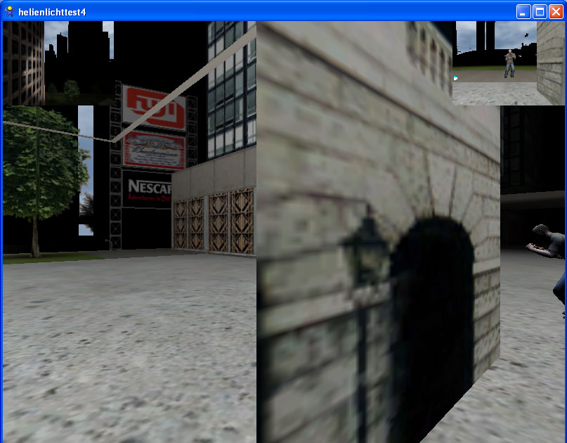

I have trouble with viz.MainView.collision( viz.ON ) in combination with shaders
This works with the standard skydome.
But...
If I add another sky routine see the code snippet below

When calling this routine is messes up the collision detection. I changed nothing added only the routine above called it from the timer so I am lost
Part 2 of this question.
In my app I created a helicopter flying a maze with a searchlight. So I added a nightmode with affect and uneffect. If you are in the light bundle the sky lights up also with this shader. bizar...
See the screenshots what I mean with this

Sorry, I am not quite clear on your question. When you say that collision detection is messed up what exactly is happening.

To define it more clearly. When I use the code as posted here# the collsion is not working or something. When we use this code to generate nice moving clouds etc. The user is able to walk trough objects. (about a meter or so. If I use the more simple skydome code. The collision works normal. So my conclusion it has to do with the code as posted. Because I did not change anything else
