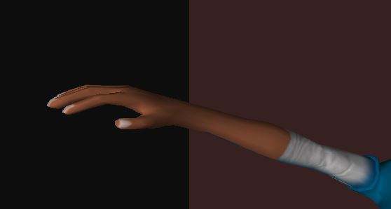

Dear all,
I need to spin arm bone of my avatar so that avatar can show something kept parallel to it. The parallel object is at eye height. So when i rotate arm it is looking so bad and long. I am using following code
My code is:
handup= vizact.boneSpinTo(armBoneR,mode=viz.AVATAR_LOCAL, euler=(-40,10,60),speed=60)
fingerup= vizact.boneSpinTo(armBoneRF,mode=viz.AVATAR_LOCAL, euler=(-30,0,90),speed=60)
h1=avatar.runAction(handup)
h2=avatar.runAction(fingerup)
Is there any other option to make it looking decent. Adding picture for reference.
Please do help
Vishav

How many bones are in the arm hierarchy and which bone are you applying the spin to?
